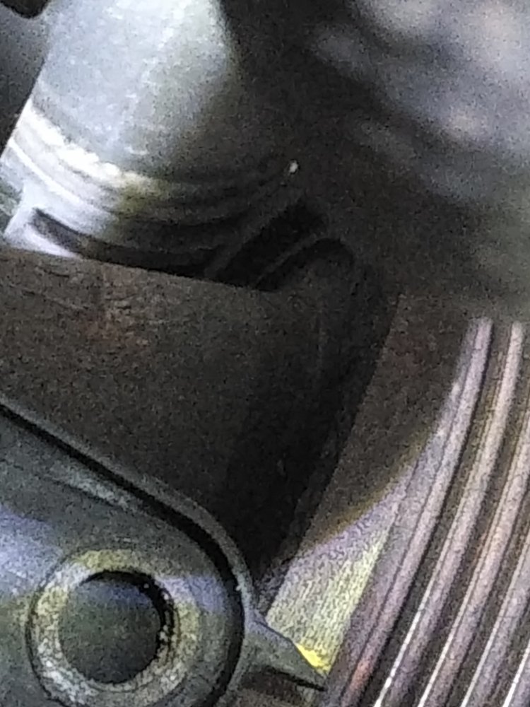

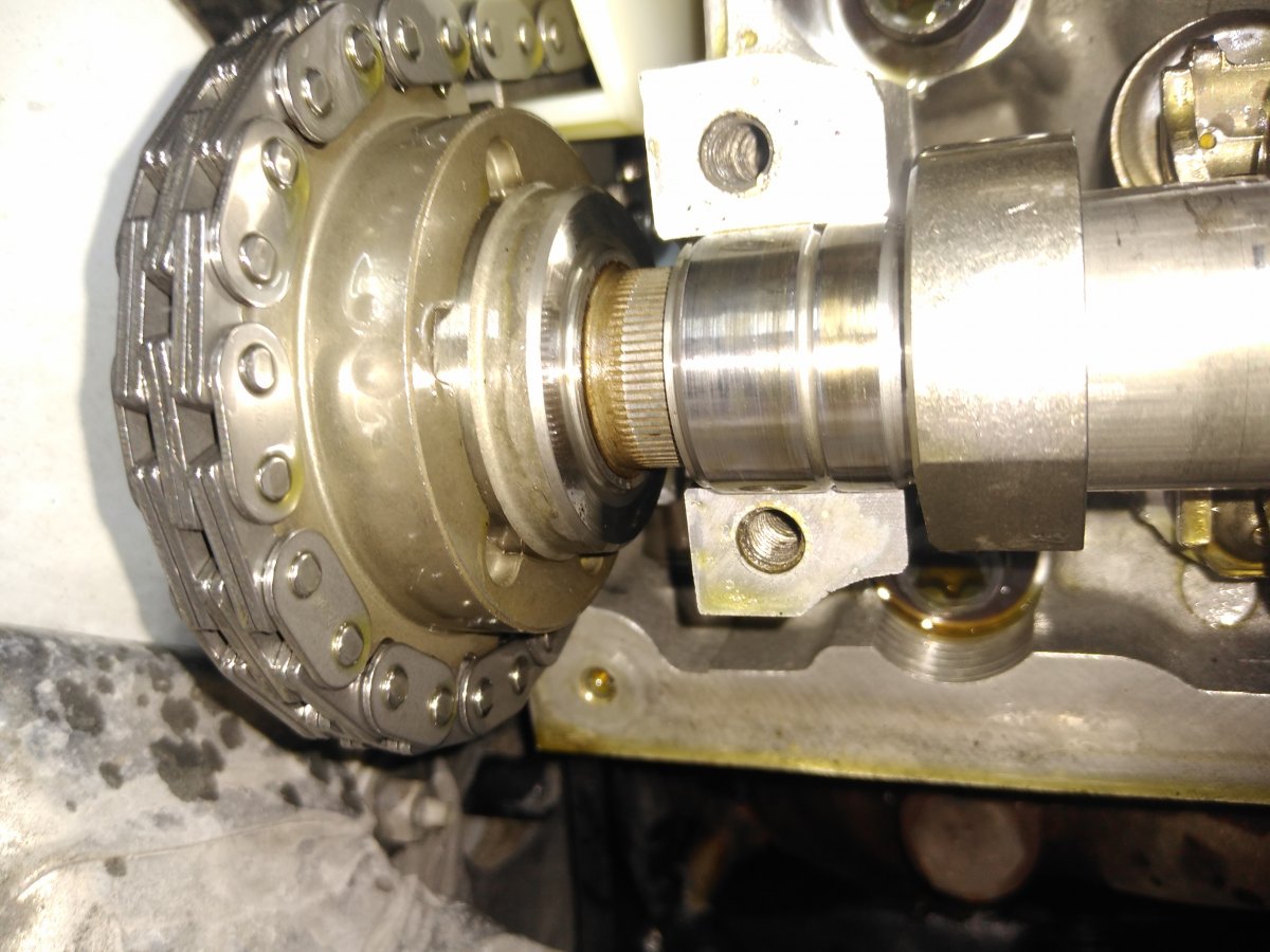

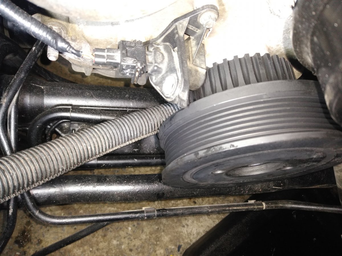

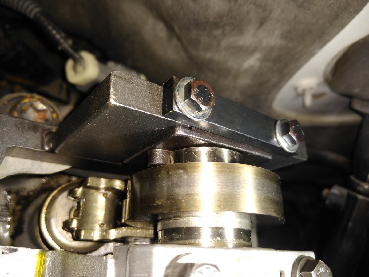

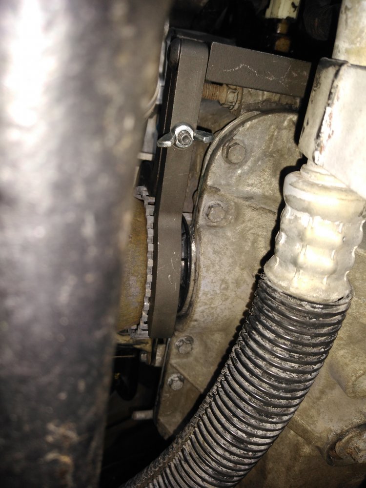

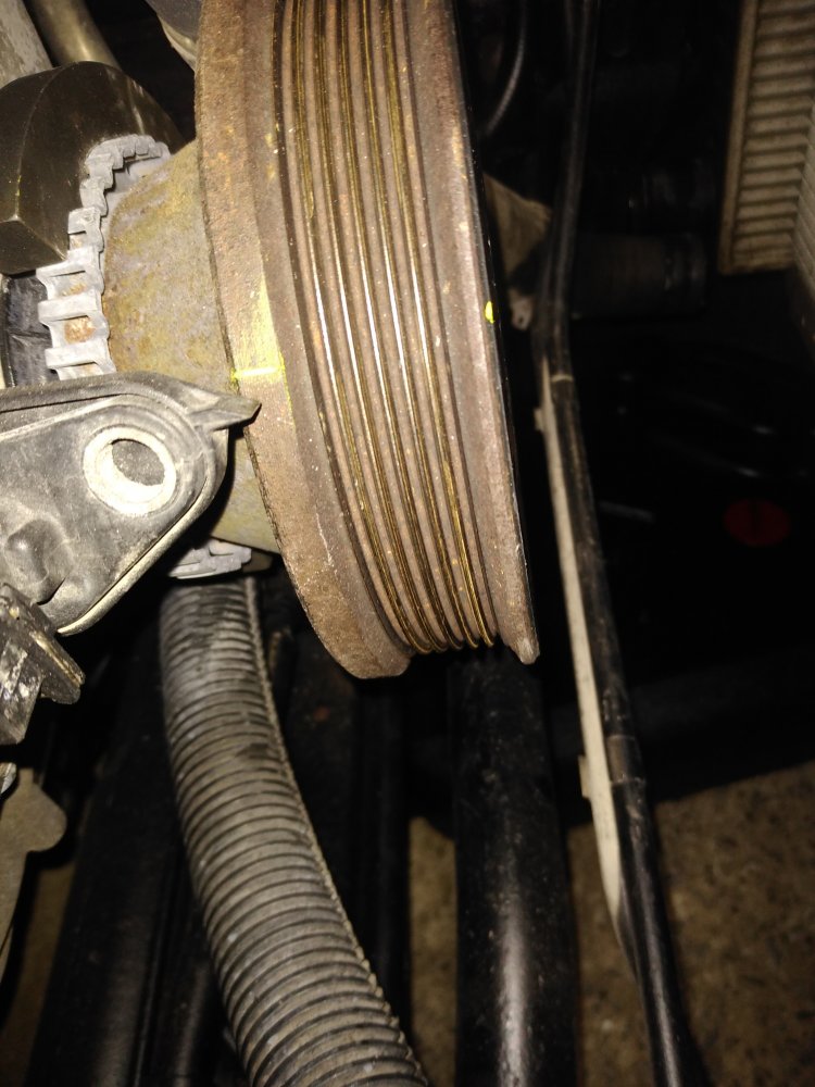

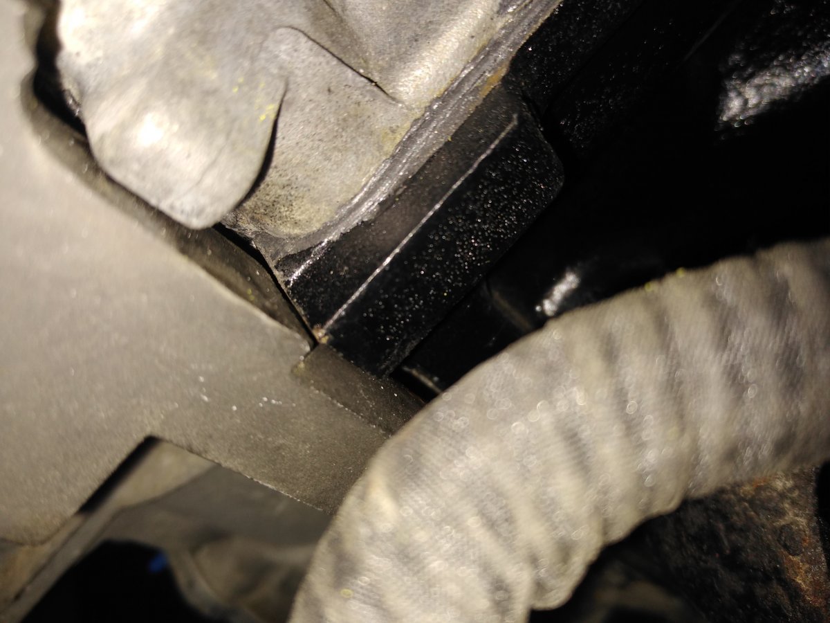

I picked up the truck from the dealer today. I was told it is out of time, and the CMP does control spark on the 2011. Anyway when I got home I pulled the driver's side valve cover and installed the timing tools. They fit just as good as when I timed it originally, but I did find a possible problem.
The crankshaft TDC mark on the balancer is slightly off from the pointer on the CKP. If the tone ring has moved, this would put the engine out of time. Has anyone ever had this happen with the stamped sheet metal type?
In the pictures the timing tool is against the block and in the proper location on the tone ring. The cam tool goes right in the camshaft and the CMP lobe is pointing up. I couldn't get a straight on shot of the alignment mark on the balancer.
I'm going to install a new balancer and check the timing again. I think something is wrong with the alignment of the tone ring.

I have seen the outer hub on the crank pulley slide back and grind into the crank sensor, it may have also turned so the timing marks were out of position. It would be worth verifying that TDC is where the mark thinks it is before you do a lot more work.
IT RUNS!!
I removed the radiator and condenser to gain access. I was able to get a better look at the alignment mark on the harmonic balancer. It does not line up to the pointer for sure with the timing tool installed. I removed the balancer and installed a brand new one I had. I wanted to check the timing with another one to see if there was a difference. Just out of curiosity I connected everything back up and put a spark tester inline. It started and ran! I couldn't run it but just seconds because the transmission lines were unhooked with no radiator.
It apparently was a defective harmonic balancer. How and why I don't know. Because I had a injector pulse with a noid light. I didn't change the cam timing. Tomorrow after work I'm going check the timing again with the new balancer and then put everything back together.

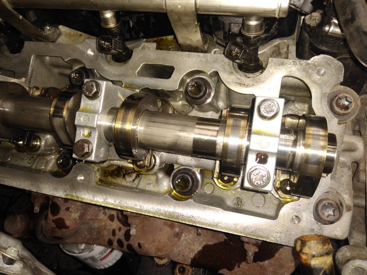

The noise was coming from the passenger side. I removed the valve cover and found two hydraulic lifter collapsed. Nothing else looked out of the way. I removed the lifters. Took them apart cleaned them and put them back in. I disabled the ignition and cranked the engine to see if they would re prime. When I came back around to the engine, the camshaft had run forward half way off the roller followers.
After digging around the internet I found another case where someone went through this. They went through 3 camshafts before they figured it out. Apparently I installed a spacer backwards on the rear jackshaft timing sprocket. I don't know....
I am going to try my best to not have to remove the engine again. These 4wd truck with automatics are about the worst vehicles I have ever worked on. There is no room and everything fights you. Manual transmissions are so much better.
Is it possible to service the rear timing set in the truck?

The simple answer is no.
Actually, the only answer is no.
Unless you'd prefer to remove the transmission and fight even harder than you already have. There's also the option of removing the cab, but you still have to separate the engine and transmission to get to all of the timing system.
