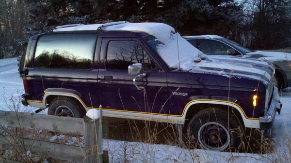

Heres a pic, not a viking fan, friend was.
