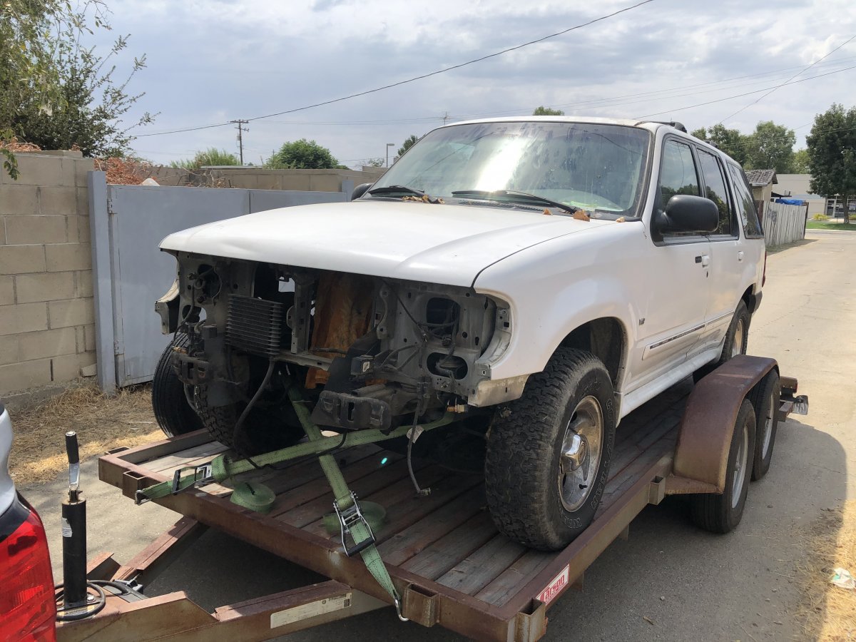

So.... I got a 2000 5.0 2WD donor for a price I could not pass up. The full 2000 donor is the key to CA legality.
I guess I’m commited to the ranger game now....lol
