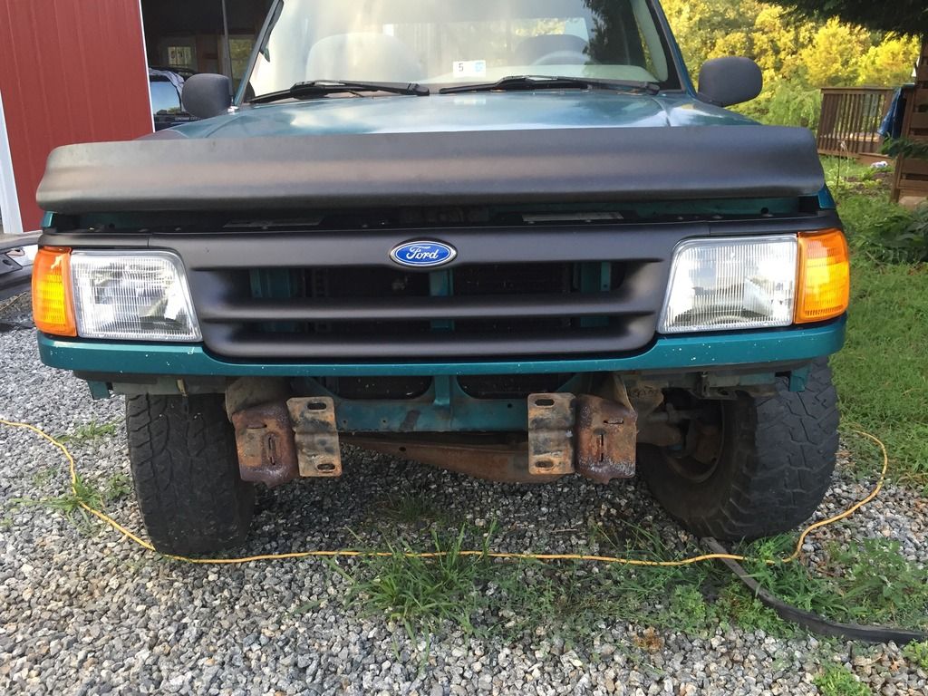

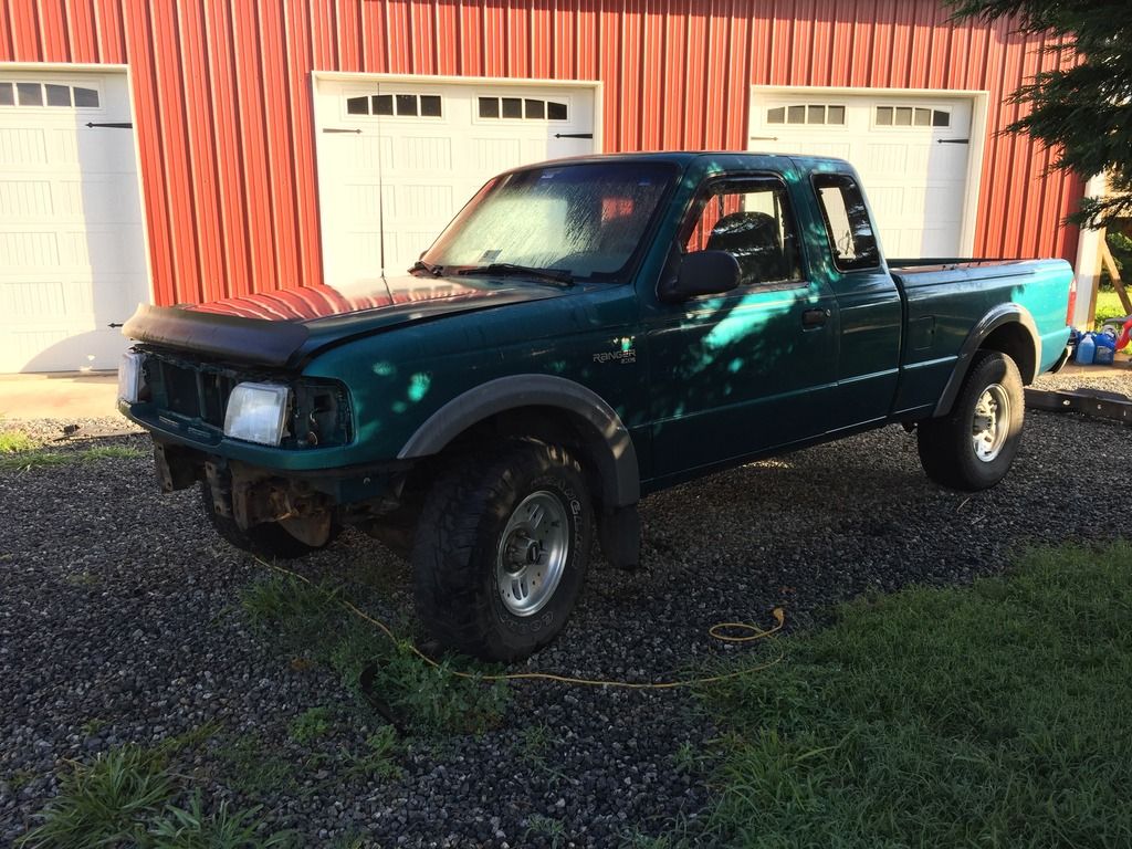

New to me 1994 ranger extended cab

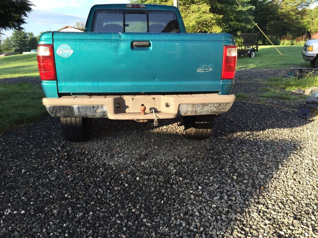

I painted my flares and put the new fender on.
put my "new" junkyard chrome bumper on

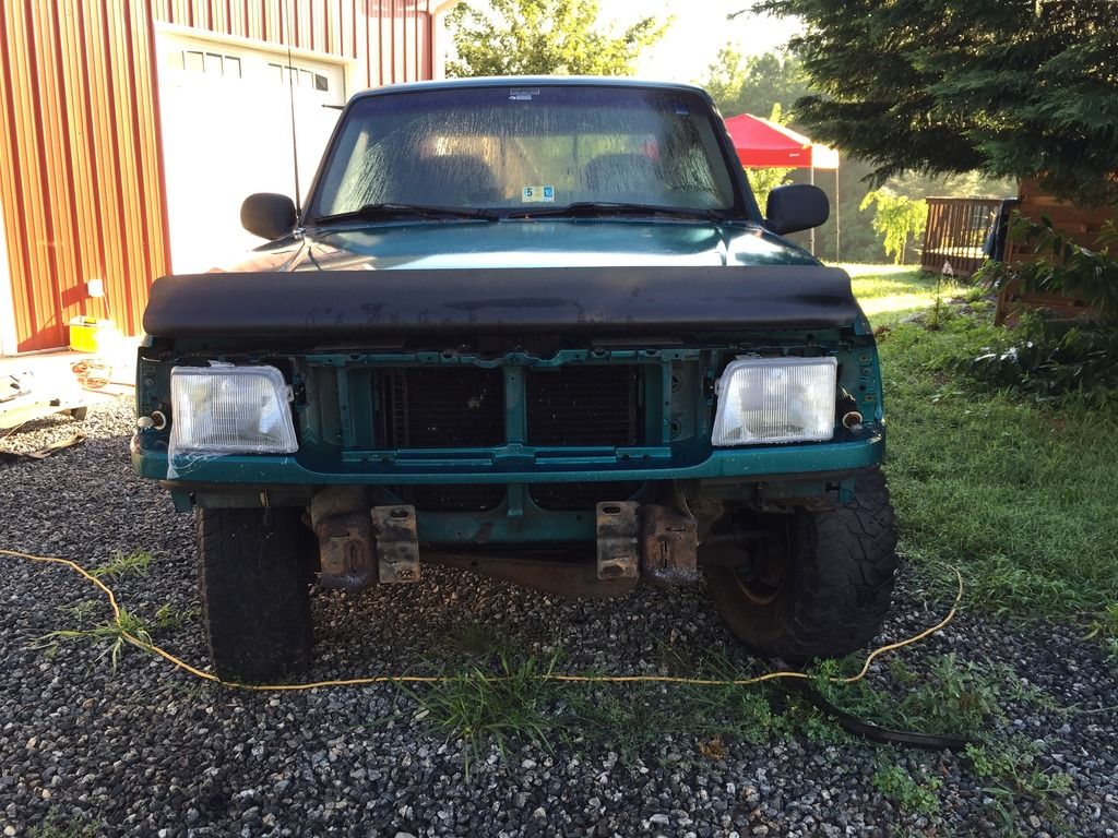

Put my "new" junkyard header panel on and installed new aftermarket headlights.
Pulled the screwed on dash trim off. I had to swap the center vents over and then cut a hole for the fog light switch on the "new" junkyard trip piece because it came from a truck without foglights and it was not 4x4.
also have a line on a good set of used tires I should be able to get in about a week.

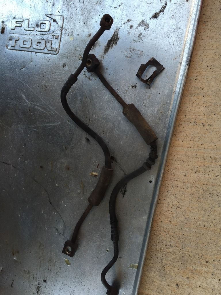

Got the grill and corner lights in last night. I'm waiting to put the bumper on until I do the cab/body mounts. Currently the truck is jacked up waiting for me to replace the front brake hoses and tie rod ends...then it should be close to ready for inspection after I get my tires.
Okay, so you are saying we don't need any kind of metal insert (like stock) to be used in addition to the prothane bushings?
I really don't see any point in using additional metal inserts. The only purpose they would serve that I can see is keeping the factory bushings stationary when the truck is being assembled.

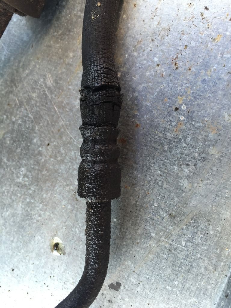

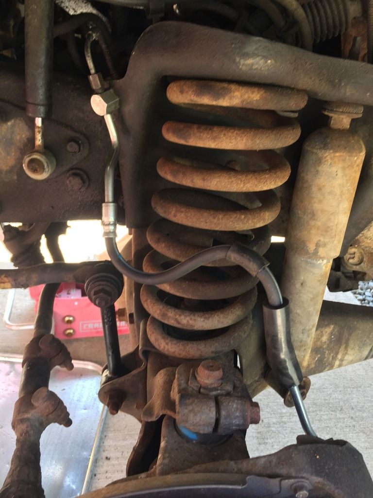

I replaced the brake hoses yesterday, they were in great shape...
The clips that were holding the brake hoses onto the back of the shock mount tower were a royal pain for me. I ended up ripping them off. I went to Napa and got standard brake lock fittings, they work great and I am sure I can get them off easy if I ever need to. Here is the part number for those if anyone needs it.

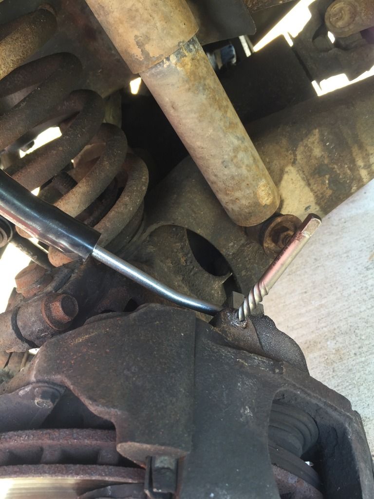

Then I went to bleed the brakes, just to find out that someone had broken off the bleeder screw on the left front. So I tried twisting what was left with some vise grips, that did not work so I tried an easy out...that did not work so I ended up with a new caliper.
