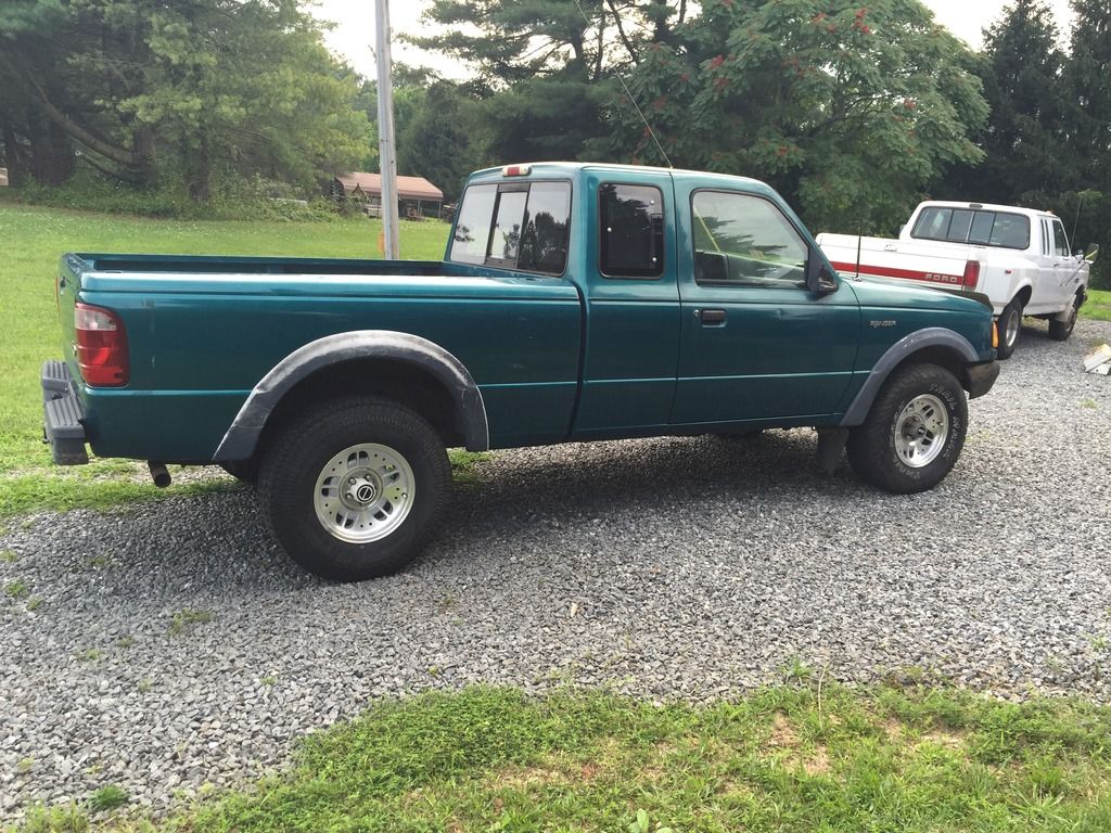

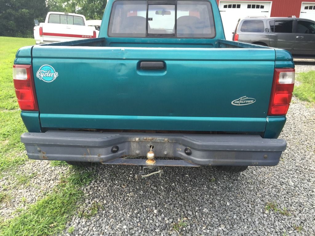

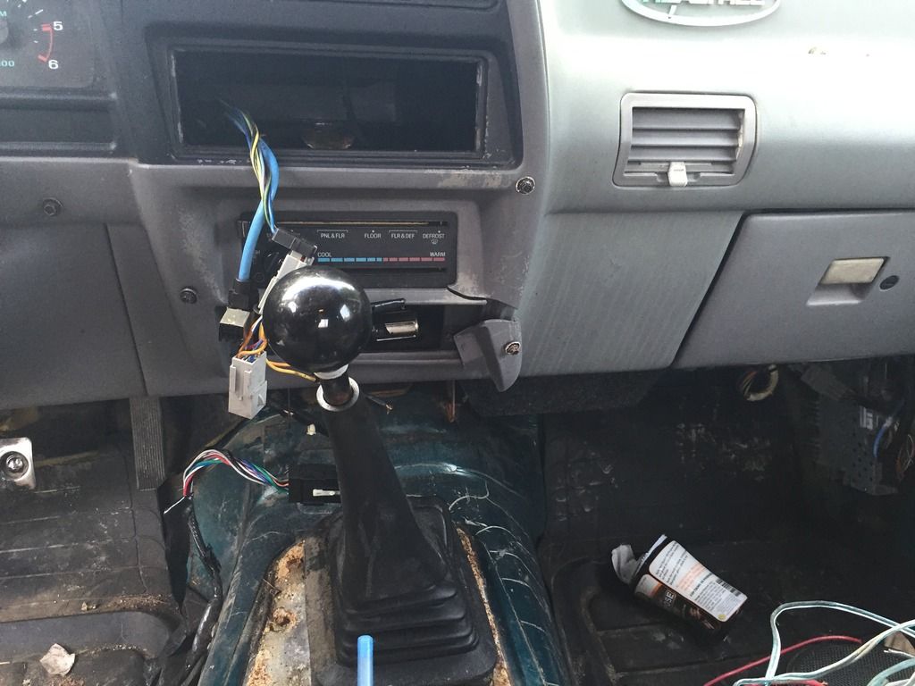

I joined this site years ago when I was doing an engine swap in my father-in-laws truck. Now I have a ranger of my own. I picked up this 1994 Ranger 4.0 5-speed, a little less than a week ago. The plan is to get it into good reliable shape and then sell my 1 ton ford truck. The truck currently runs and drives okay. The shifter is extremely sloppy (feels like you have to move the shifter a foot to the right to get into third), so I have ordered the shifter busing kit. It needs at least two tires, a side view mirror and some random body parts. The interior has no carpet and now has no radio because I pulled it out because someone wired everything direct bypassing all of the stock wiring...and the wiring was not hid well. Here are a few pics of what I am working with. I will use this thread to document progress and ask my random questions:headbang:

Does anyone know what the correct radio adaptor is to install an aftermarket radio with a truck that has the factory amp? I had an aftermarket radio installed in the truck. How do you know if the truck has the factory amp option? Where would the amp be located?

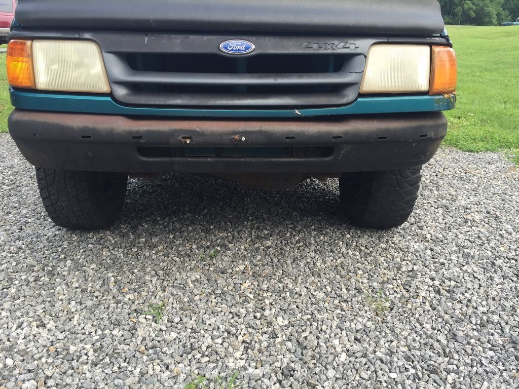

From searching around it seems that no one make factory fog light brackets. Is the only option still making something up or finding a used set? My truck has the fog light switch, relay and wiring installed so I would like to add the lower valance but I will need some brackets too.

also, what headlights are the best option? I need to replace mine before inspection. I would like something that has a clearer lenses but don't want something crazy looking. What are you all doing for replacement headlights?

The amp I would imagine would be behind the seat

I have tons of rockauto discount codes. They actually send me a Christmas card I spend so much with them every year. I know where to get stock replacements, I am more wondering about the aftermarket options since it seems they have a clearer lens. Are any of them made of glass or are they all plastic?

Is there anyway to tell if your truck had the factory amp option by just looking at the plugs coming out of the dash?

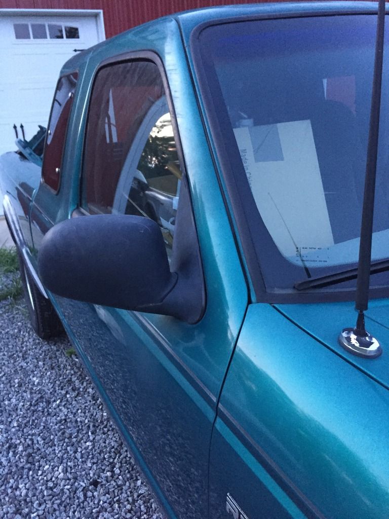

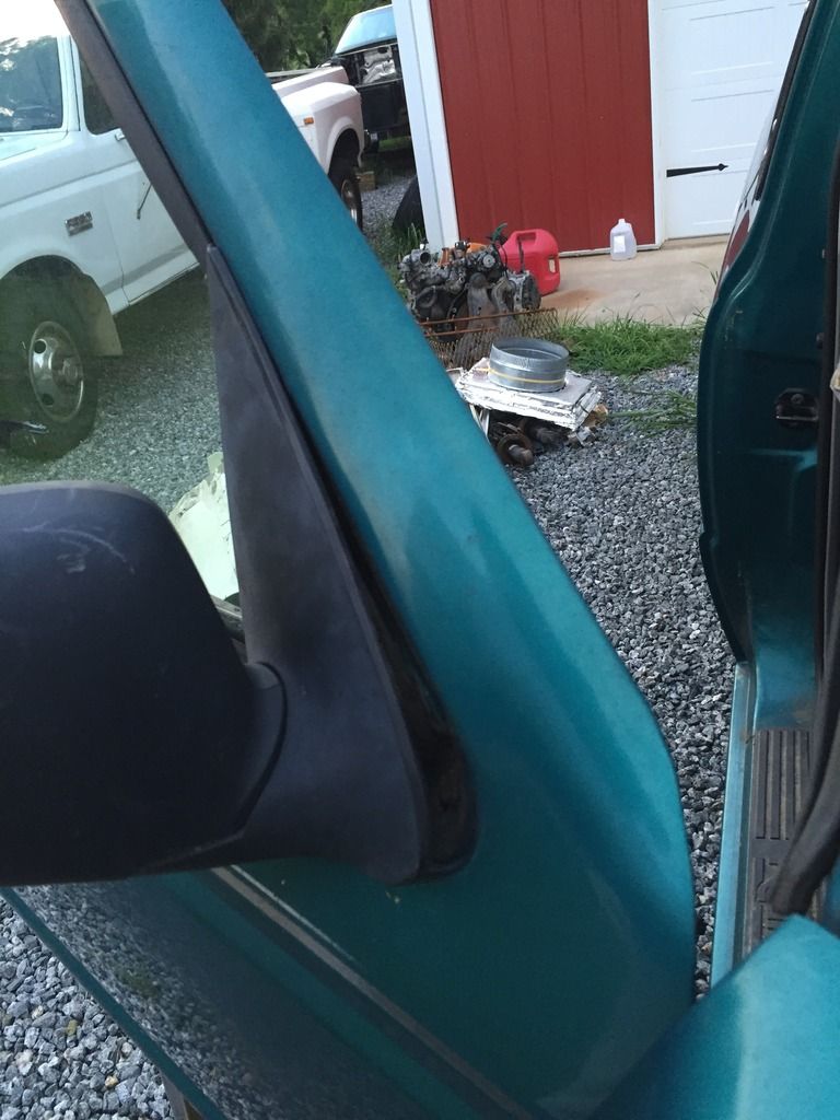

So I replaced the right side mirror that was broken off the truck when I bought it. But when I put it on I realized that the sheet metal got bent some not allowing it to seat properly.
So I pulled it back off and went to town with the hammer. Much better.

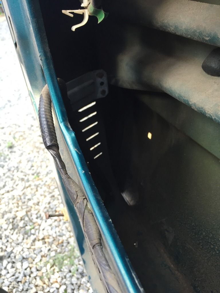

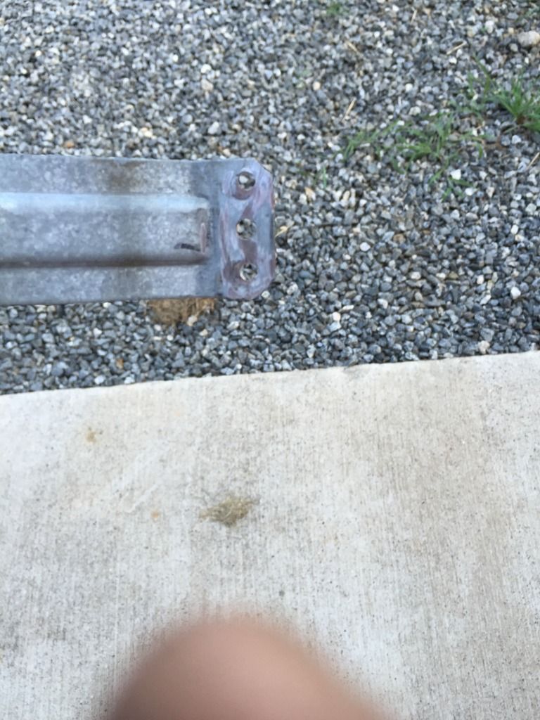

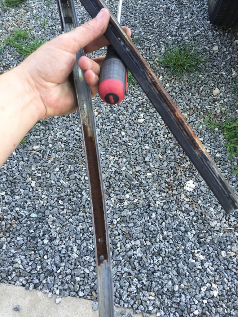

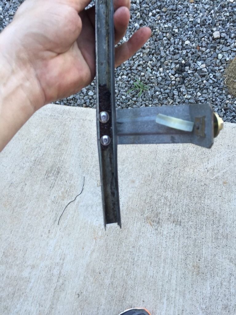

Then I starter working on the windows. They kept coming off track. Well this did not help. This rail had rusted off on both sides.
The rails had rusted away from the mounting points.
So I scraped them down and then sprayed them with rust converter stuff.
Drilled out the mounting points.
Then riveted the rails back to the mounts and put the pads back in.

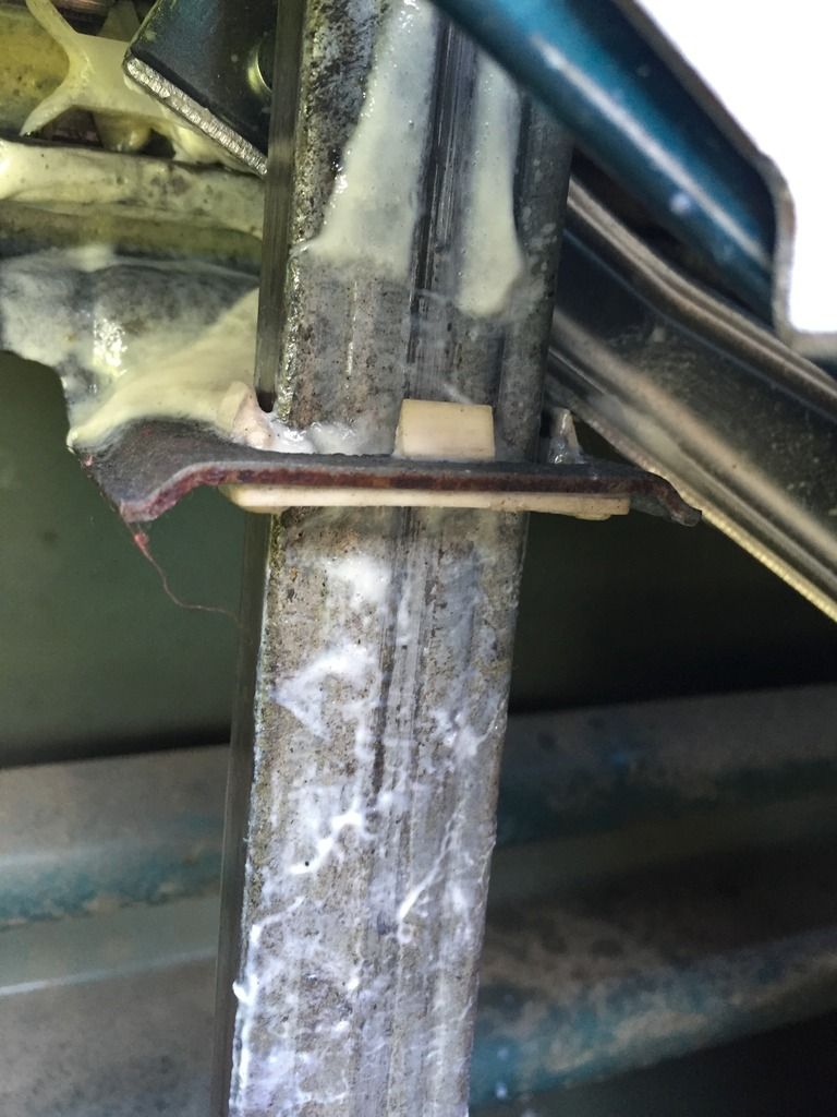

I put them back in, but I had not done anything further. Hopefully I will get some time this weekend to mess with it.
I got the new window regulators in and I can get the windows all the way up now, but it is still not the way it should be. The driver side window get cockeyed when it is about 6" from the top. It seems that maybe replacing the bushing on the center window guide may help. Does anyone know if we can get this replacement busing?

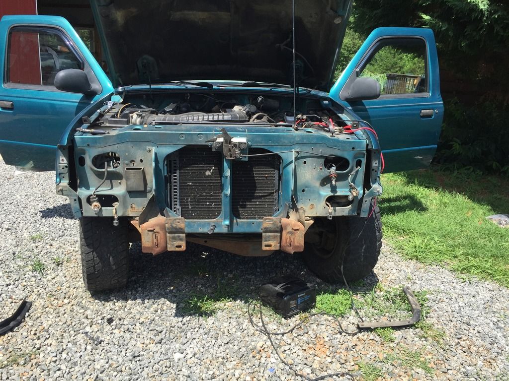

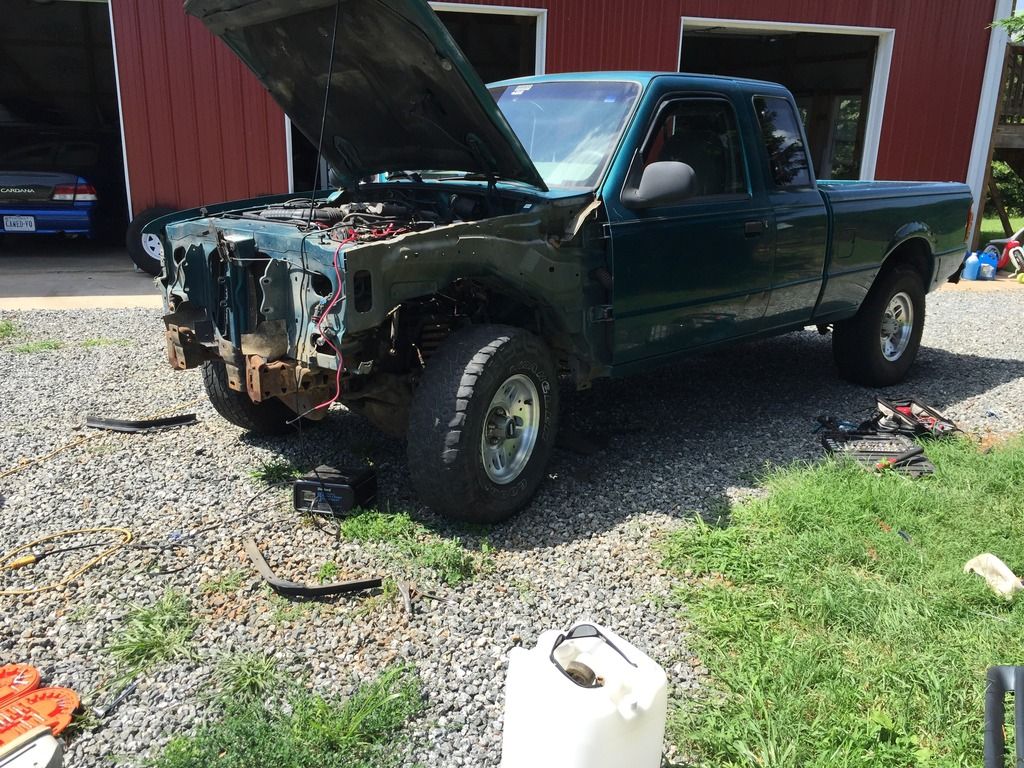

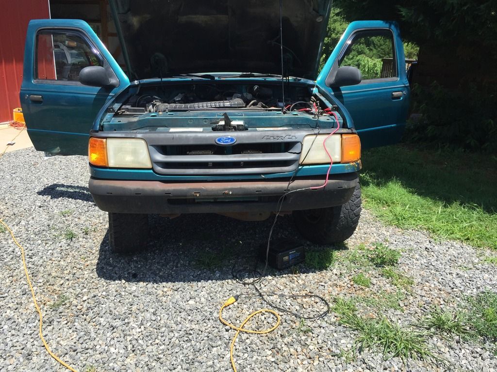

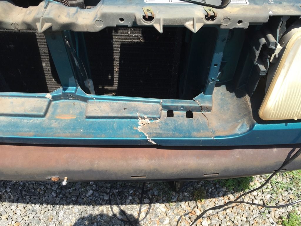

Then I started pulling front end parts off to change out broken stuff for parts I got at the junkyard/ordered in.
Here is what I started with.
Part of the messed up header panel
header panel removed.
Fender taken off
These bushings are rotted, where are you all getting replacements?

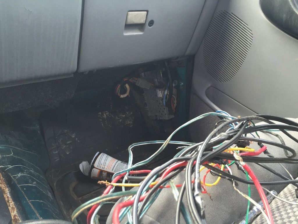

This ground wire has broken away from its grounding point. This is directly in front of the driver seat (my carpet is removed). Does anyone know what this ground is for?
I repaired that ground wire pictured above, and I also cleaned my transfer case shift motor. Now I have working 4x4.
