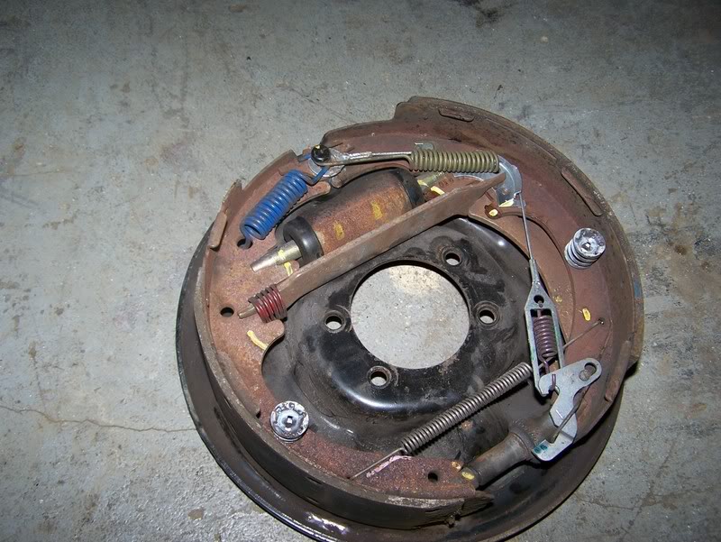

It is the correct photo... showing correct installation of the hardware.
