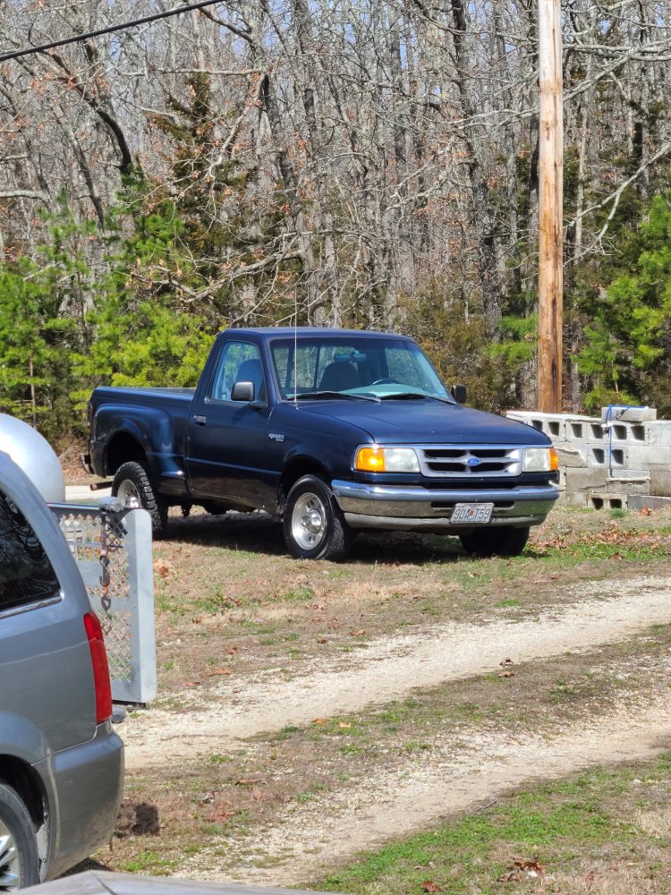

Hello, I am new so if this is in the wrong sub forum I apologize. I just bought the truck last week for 2,000.00. It's got 158,xxx miles. I noticed after filling it up today that the gas tank seems to have a small gas leak. I have looked all over online for a replacement tank but none of them seem to say that they fit my truck once I enter the info for my truck. Does anyone know the correct tank and possibly have a part#? It's weird that I can find the other years but not the 97. Thanks for any help you guys might be able to give.

The good news is, its probably NOT the gas tank that's leaking, its the Filler/vent hose that's cracked and leaking, especially if you notice it after or during fill ups

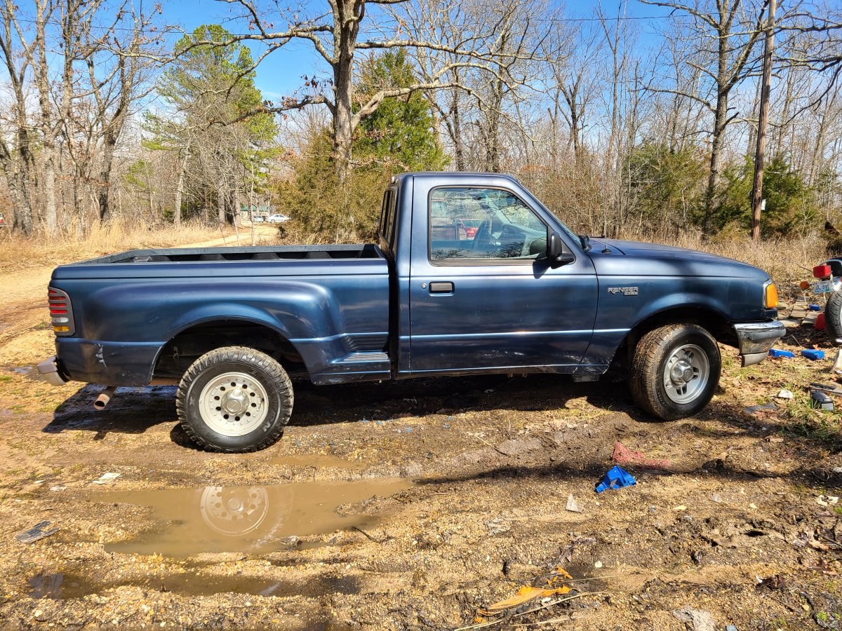

You have a Stepside, Ford calls it a Flare side, so your filler/vent setup is different than "regular flat side" bed truck
So replacement needs to be for Stepside/flare side
Have a look under the truck on that side and feel around with your hand for breaks or gasoline on the outside of the filler and vent tubes
Easiest way to replace filler/vent or find a gasoline leak will be to pull back, or tilt up, the bed to get full access to the top of the gas tank
There are 6 torx 55 bolts holding down the bed, and 3 screws on filler(gas cap)
There is also the tail light wiring harness that needs to be unplugged if you are moving the bed back or off
But you can tilt the bed up and brace it to get access
If you have a lift and transmission jack then Dropping the tank is also an option, but I don't recommend this as a driveway/garage repair method, because its very very hard to get wiring and hoses back into place and then lining up the straps to re-install
Things to look at if bed is up, rear leaf spring hangers rust out on ALL pickup trucks, so on Rangers as well, these are much easier to change if bed is off
