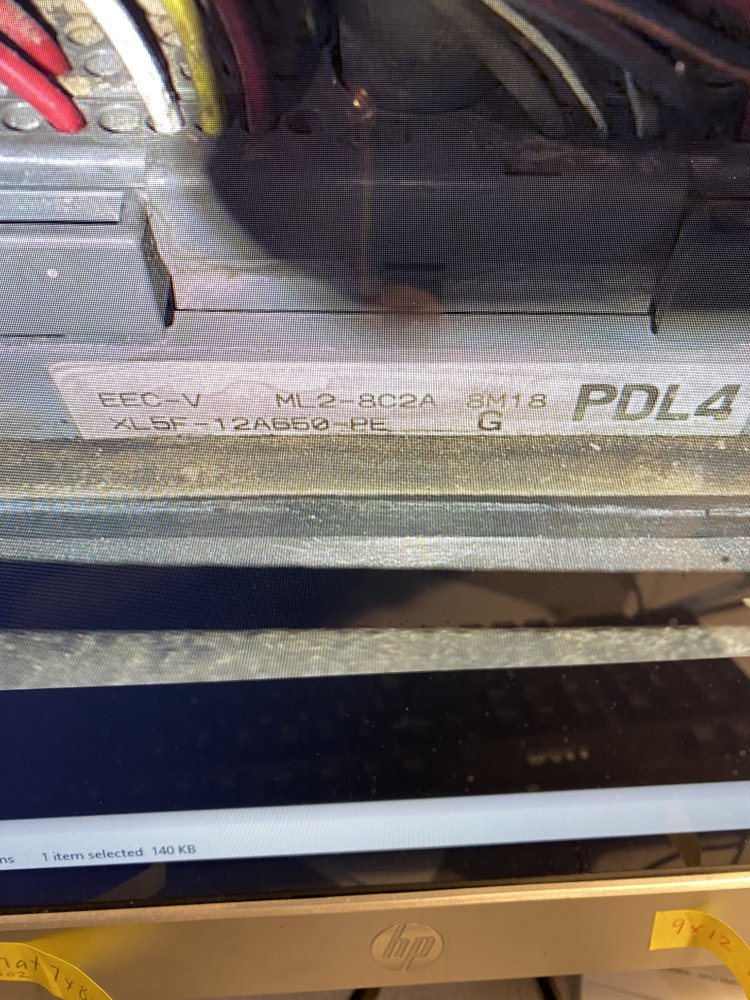

This is what I have. 1999 XL 3.0.

I’m not familiar with the computer codes but a 99 3.0 should be using a chip key and have PATS. The PATS module in the 98-00 trucks was it’s own module buried in the dash separate from the PCM. Having a PCM made to your specific VIN is not really important for a 98-00, it just has to match your vehicles configuration (engine size, transmission type - auto/manual, and Federal or California emissions). Having it programmed to VIN will still leave you having to program keys (which also can be done with Forscan and an extended license). The VIN programming only becomes more important when PATS got integrated into the cluster.
