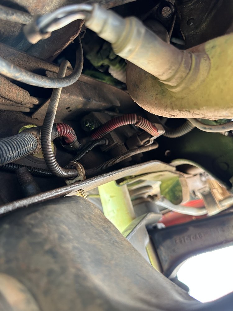

Need help identifying this part.
Nov 8, 2022
6
Tn
1994
So i bled all my brake lines. Because the other day i check the brake fluid I noticed it was really dirty also my brake pedal would go slowly to the floor. So bled the lines and the next morning I had brake fluid by my driver side door so I went under the truck and saw this part leaking
That would be the Rear AntiLock Brake System (RABS) valve.
For my 93 and I'm fairly sure your 94 they have fairly well classified that valve as discardable
