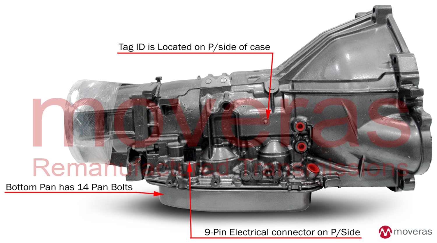

Outside of a Vehicle with its wiring harness still attached...
Figured out my wiring issue, but won't be able to see what in the hell I'm working on with it in the truck and can't envision it... I don't have any good quality pictures of my setup out of the truck sadly...
May have already found it...
Pass side, 2/3rds the way back it looks like

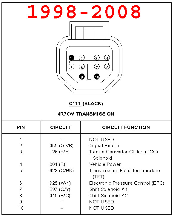

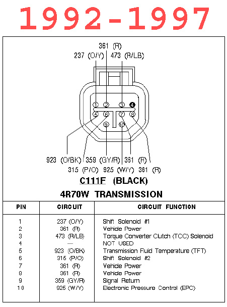

I have the pinouts... Next thing I need to do is dig out my EVTM.... :sad:
Oh, OK. The pinout is different on the 93-97's than the 98-07 according to my source. I thought that might be what you were after.
The picture I have has a completely different connector for 98 and up. Let me know if you need the PDF.
