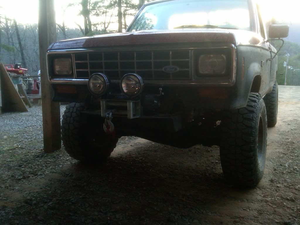

now that i have my winch and lights hooked up i think im in need of a much bigger alternator in place of my stock 60 amp junker lol. does any one know of a alternator that will work with the same connects on the back? im not to worryed about mounting it. and will a 1000 cranking amp battery kill my starter or would it be ok?
