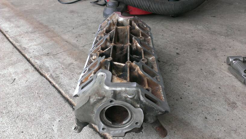

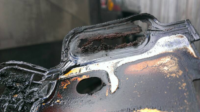

My 92 started pouring antifreeze and just got to taking the engine apart to find its shooting out from my intake gasket. The gasket is pretty beat up haha.

Oh freaking swell. Another dirty little secret about the 4.0 How can I prevent this from happening to the Rat? What is the time and price for parts for this? I know, price is prolly not too bad. Time depends upon too many variables to worry about. :D

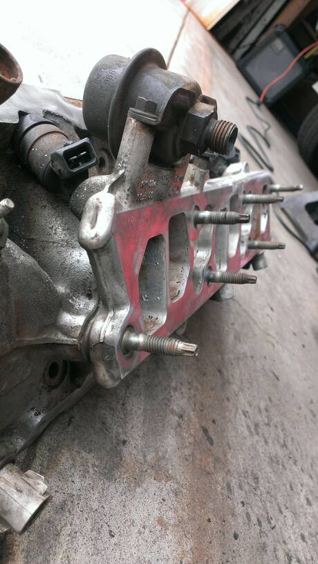

Yeah I went to advanced autoparts I bought the kit and the valve cover gaskets as well. Getting the intake ready to put the gaskets on now:D

What, gaskets can go bad is a "dirty little secret"? That is a possibility on ANY engine. It can't really be predicted either, just keep up with normal maintenance.
Yeah I agree. I had been trying to track this leak forever until the day it decided it wanted to just spout out of the back of my engine. Last place I would of thought to check... :mad:
