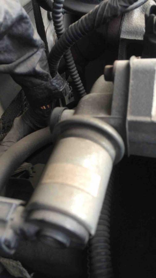

It would appear that the MAF is underreporting at warm idle, which suggests that there is a an air leak. I didn't see any smoke emitted when I pumped smoke into the brake booster hose, except for a little coming out of the IAC valve. The smoke was leaking out (just a little) from the black round cap that faces the rear of the engine compartment. Could this be pointing to a leak, and the cause of the lean condition? If no, perhaps there's a leak somewhere that I can't see (internal?).

Here's a picture of that IAC. You might not be able to see the smoke, but it was coming out of the black round cap that faces the rear of the engine compartment.

The black cap snaps off.
It is the vent for the valve so it can open and close, it equalizes pressure on the back side of the IAC Valve.
With IAC valve closed you might get smoke from there, would depend on the design.
It looks like this one: http://www.explorerforum.com/forums/showthread.php?t=84220
When unpowered/unplugged the valve is closed, in the pictures you can see the back side looks to be open all the way to that vent area, so would be a "planned" vacuum leak.
I would pop off the cap and see if filter is in place.
