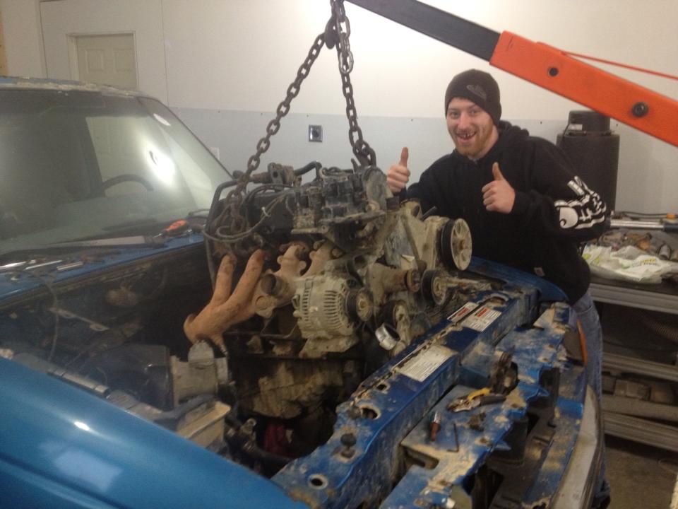

i had a little time today to mess around but had to clean my garage so that i could start tearing it apart. should have the front end off this weekend if everything goes as plained. and what do you guys think about running a 3 link setup? i am making my own long arms was gonna go with the 3 link :dunno: but heres pic of the truck now and my axles that i need to start working on to btw
