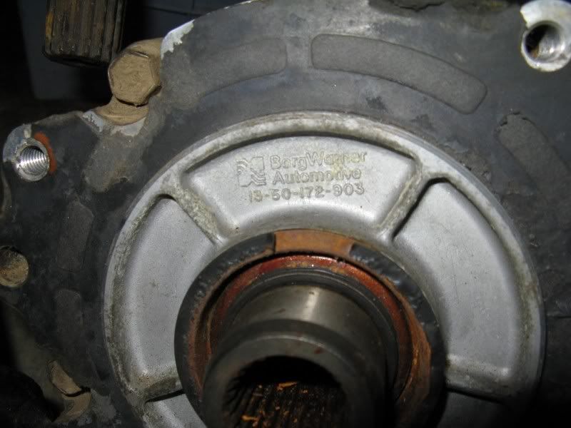

The case that just knocked the wind out of me, say's 1350 in a series of number in the input housing.....making sure I'm not seeing things or its a random number I check my E case and sure as shit it says 1354.....I figure what the hell, the driveshafts bolt up, the shifter bolts up I'm gonna use it anyways but here's my question....

Was this case built from a 1354/1350 pile of parts as a replacement? It's got a bead of RTV on the split so I know it's been apart but I thought for sure that 90' would have a 1354 or the 1350 in that year would have had a slip yoke? Also, should I be worried about it's strength in relation to the 1354 as it's a 5000lb truck on 35's locked front and rear?

You might be seeing what is an early 4-planet 1354, the face of the input bearing plate did say 1350 on these, but you'll notice the case itself says 1354 elsewhere.
Good to know, and thanks guys. I'm gonna say its junkies third idea as it definately says 1350 on the input plate. It's identical to the 1354E I pulled besides the obvious manual shift and it's got a plug of some sort above the front out put in the case that the E version didn't have, no idea whats it's for...any ideas?

I pulled a electric transfer case out of an explorer to replace one in a ranger. It had the double cardan front shaft, but the case said 1350. Tag identified it as a 1354.
