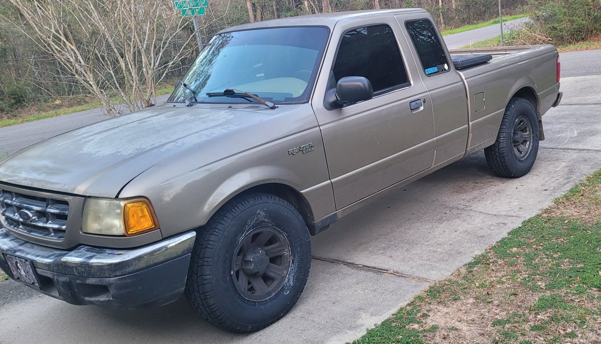

how I got it and with new tires (Iron man AT 2's 31x10.50x15:

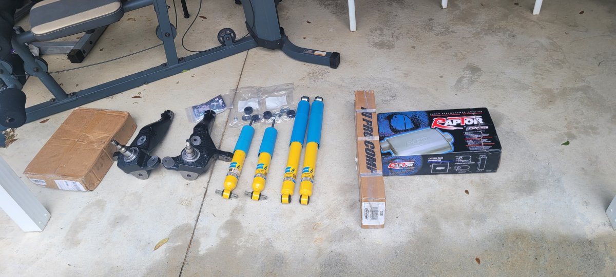

NEW PARTS!!!
List from left to right:
Amazon front end kit https://www.amazon.com/dp/B07PQRGM8X?tag=959media-20
Front end kit includes upper control arms w/ bushings and ball joints included
new tie rod ends (inner and outer) I didn't replace the inners this go around saving for a later date
Sway bar links
Lower ball joints
Next is the WULF SUSPENSION 4" lift spindles I got in a kit with an add-a-leaf for just under $400
Bilstein 4600's
And last but not least a cheap Raptor muffler you can get at just about any auto parts store (I ordered mine online from the cheapest place I could find it. Holley.com for 40 bucks)

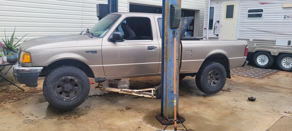

Time to tear it down, on the lift it goes:

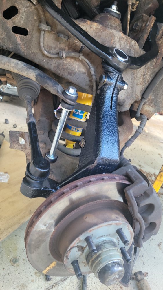

On to the juicy part of this mod of the truck. So in order for the lift spindles to work properly and have clearance you have to take an angle grinder or cut-off wheel to the lower control arm and shave off the bottom flare all the way around the end of the control arm. Let the sparks fly!!! After cutting that lip off i took some black spray paint and shot it on there to prevent it from rusting out. And now the not so fun part, Getting the lower ball joint out. There are a few ways you can go about it, luckily for me I have a ball joint press... Much better than beating it out with a hammer. Done that before its no fun and take awhile and you'll probably round out one of your big sockets on either side. Pressed that puppy out and throw it as far away as possible cuz its dookie now. Press in the new lower ball joint that came in the front end kit, slap on the ring clip attach the New upper control arm to the frame aaaannnnnnd we're ready for the new lift spindles!
So as you can see here^^^ laying on the ground right there is how much you have to cut off the lower control arm. Be careful and wear a face shield. Metal in the eye sucks I know from experience.
Now that the new spindle is in i can now change out the front shocks and put the new tie rod ends on.
Unbolted the 2 nuts on the bottom and 1 nut up top on the shocks. Had to get a pair of vice grips to hold the shaft from spinning and used a ratchet wrench below it on the nut. Slapped on the new sway bar links put the tie rod end into the spindle but left it loose until I could set it on its own weight and see about getting it lined up as best as possible without taking it to the tire shop.

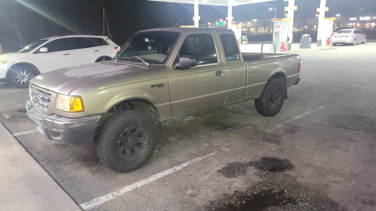

Took her on a test drive to the gas station up the street and I'm pretty stoked. Thought it would take me longer but actually got it all done in about 6 hrs.
Don't know what the future will hold quite yet but I'm looking into getting some 2" lift coils and then putting in the rear add a leaf. but for now here she is:
