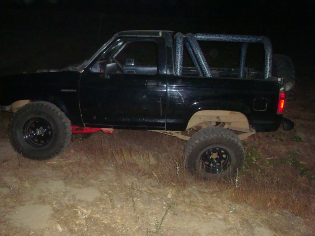

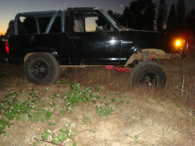

I rolled my rear fenders, added 2" shackles with long travel shocks,4" spring over custom springs, get about 16 inches of wheel travel in rear
Thats all I get out of mine. The rear shocks are bottomed/toped out respectively. I still need to trim my fenders and work on the rear shock mounts, but the springs will do more.

Considering that those are 37"s without any fender trimming, I don't think it does too bad. Like I said, I still have some tuning to do.
