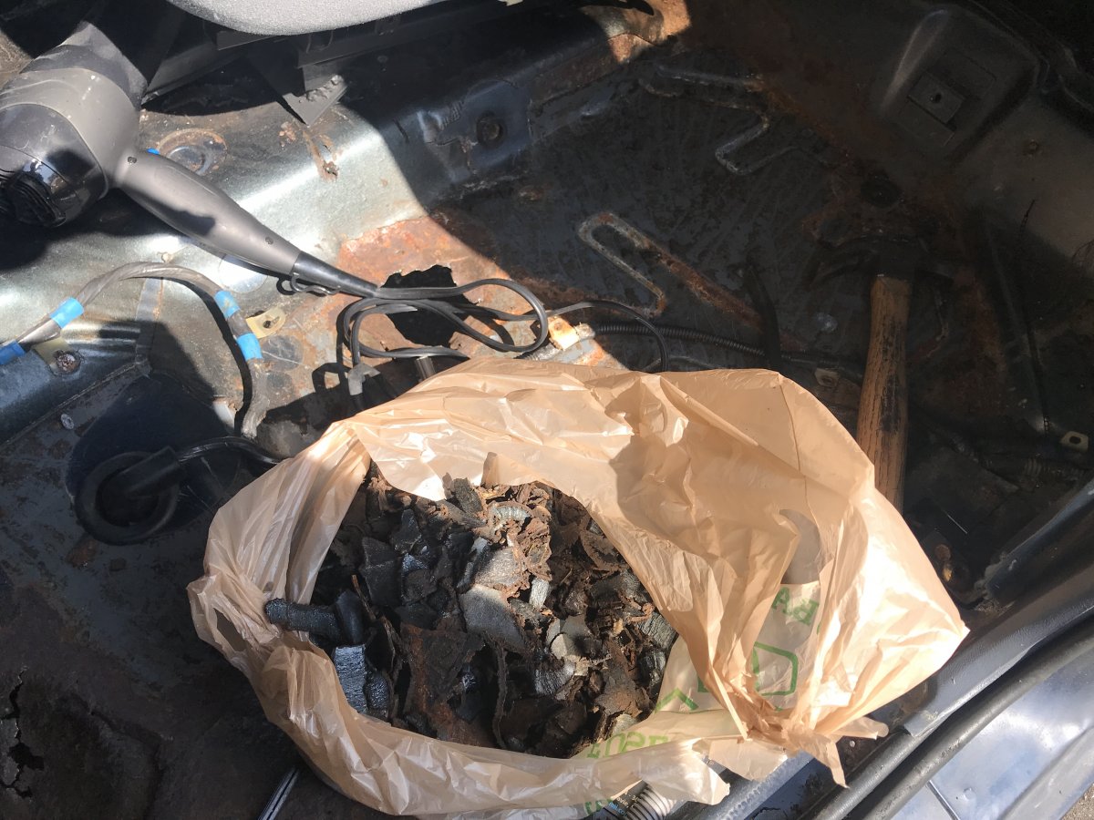

In my last thread I talked about removing the interior body liner. A heat gun (definitely not my mother’s hair dryer) and the flat end of a pry bar did the trick.

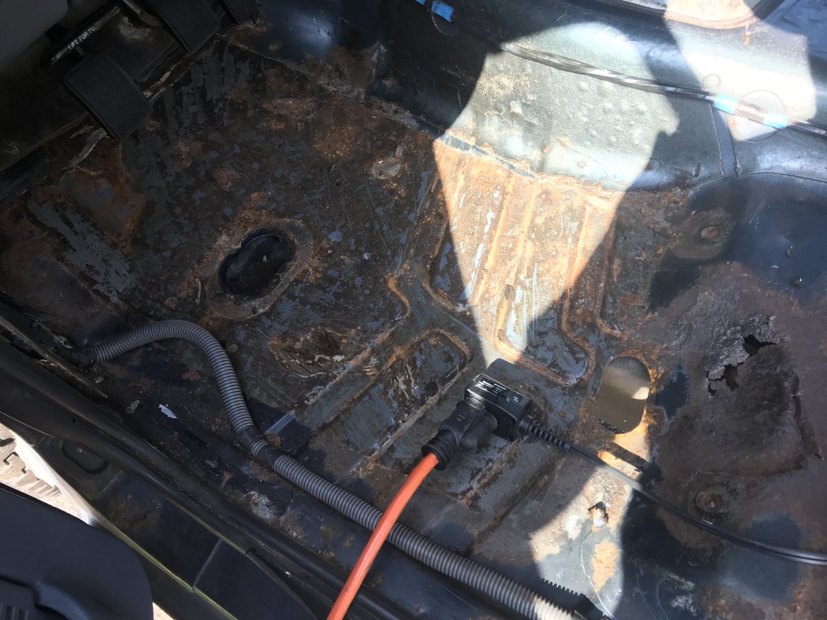

My harbor freight angle grinder died and I finally got around to buying a new one. Ryobi this time around. I hit the interior with the wire wheel and it’s cleaning up nicely. I haven’t decided if I’m going to fiberglass the holes or figure out how to weld in some spare metal. I’ve never welded before.

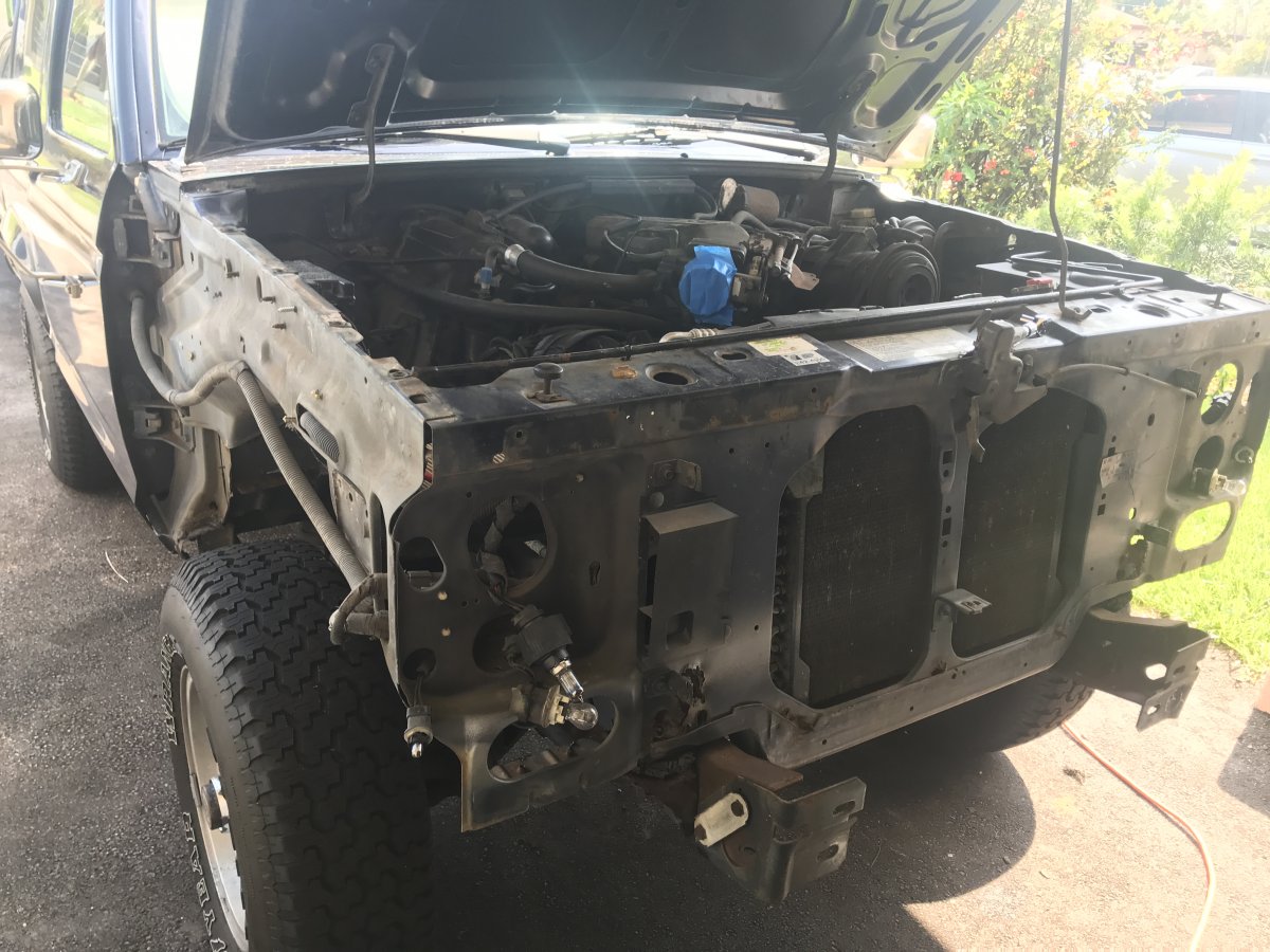

I got the two fenders off to reveal some more rust holes (relatively minor) in the body behind the finders. Same story as the big holes in the cab, but almost definitely going to fiberglass these because they’re hard to reach.

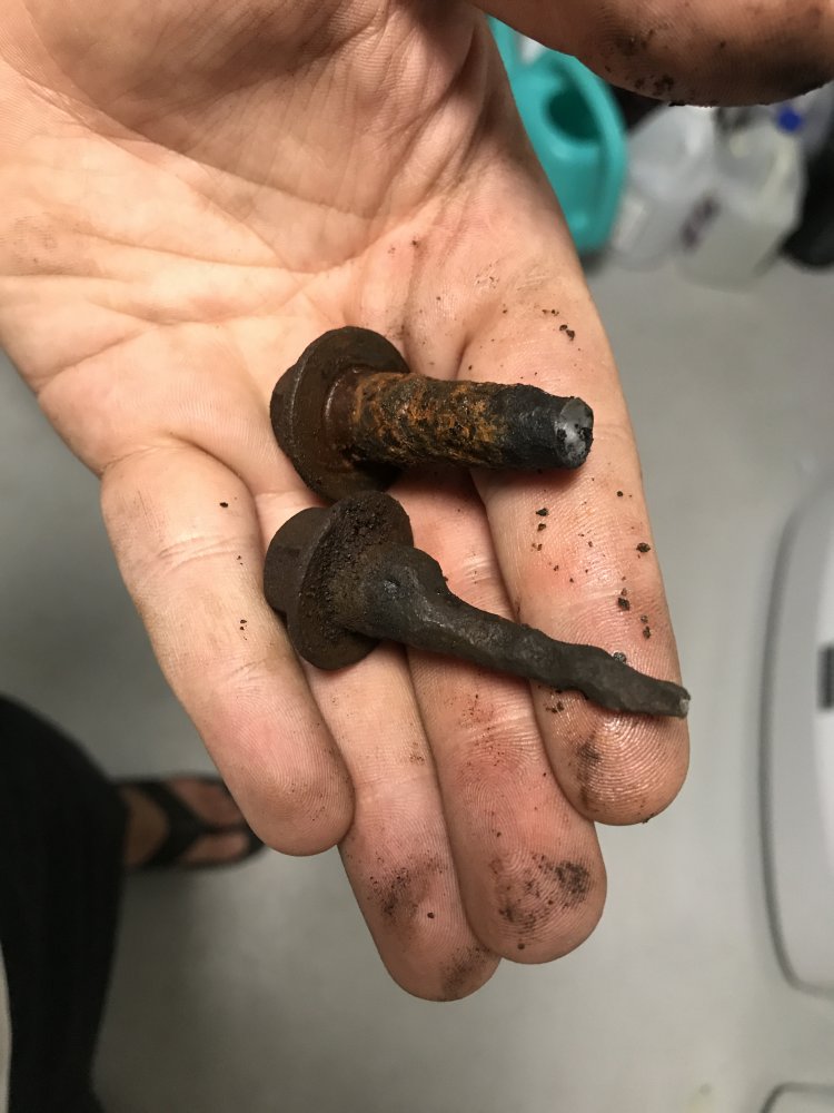

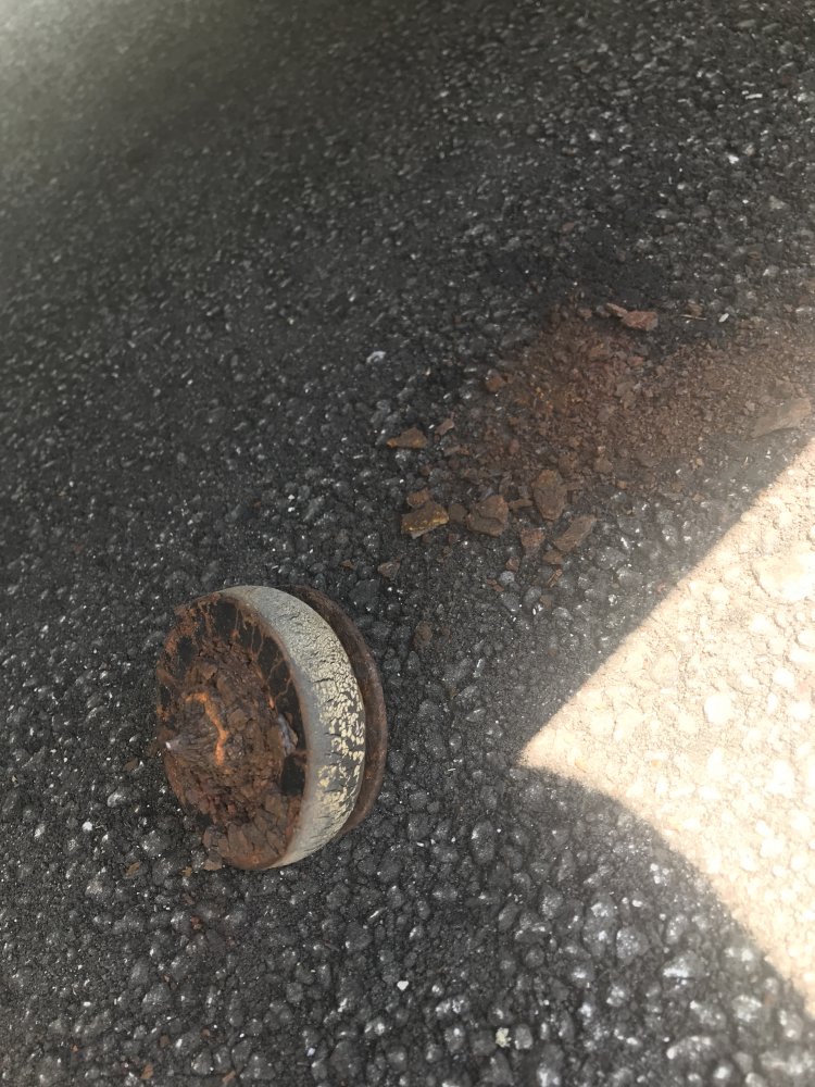

I’ve been spraying down the body mounts to get the ready to take them out. I decided to try and start loosening them and the drivers side bolts are completely rusted through. The bolt and the bushing just fell apart. This truck definitely shows it’s Pennsylvania roots.
Other than that, i want to brush off the rust from the frame and paint it. I thought about completely removing the body off the frame to do this but it is probably more work for me than it is worth. I’d like to learn how to do this one day. I’ll have to get what I can from underneath when replacing the body mount bushings for now.

I used Eastwood products on my rusty frame last year and it is holding up great so far. All you do is remove the flaky rust with a wire wheel and paint.
I basically lifted the body up about 6 inches off the frame and placed it on saw horses. I had just enough room to get under there and work. Of course if you have the means to lift the body right off, that would be a whole lot easier. Keep us posted!

I guess i’m not even sure where to begin with lifting up the frame. Mind you I’m not terribly experienced, but I can figure this out. What’s involved. I can see the for the most part it seems pretty modular. It looks like I might have to take the steering column apart and probably drop the gas tank to get to the rear body mounts.

On the fiberglass repair, I have used it before, it works well and gives a good repair on non-structural things like floor pans and body parts. I just mix the resin in a can, paint around the repair area with a paint brush, and then stick the resin cloth onto the painted area so it sticks. I then just start painting the cloth and saturating it with the brush. If you try and saturate the cloth and then install it like the instructions say, what a mess that makes.
I would try to put metal in like a floorboard area with the body mount below it. The fiberglass won't support the body as well as metal would. Even with the metal, you can use screws or pop rivets.

I would rather see steel used for the floor repairs, welded in is best but I'd even pop rivet it before fiberglassing a floor pan. I used POR15 on my Ranger to cover rusted surfaces. You need to remove the loose rust before applying it and when it cures it catalyzes the rust and stops it's progress. I found that the only solvent that cuts it is the POR15 solvent, chip brushes worked best for me and they're cheap so you can toss them, if you're not going to cover large areas at one time buying a six pack of small cans worked better for me than trying to keep the lid from seizing in place. WEAR GLOVES and avoid getting it on your skin because it's near impossible to get it off.
