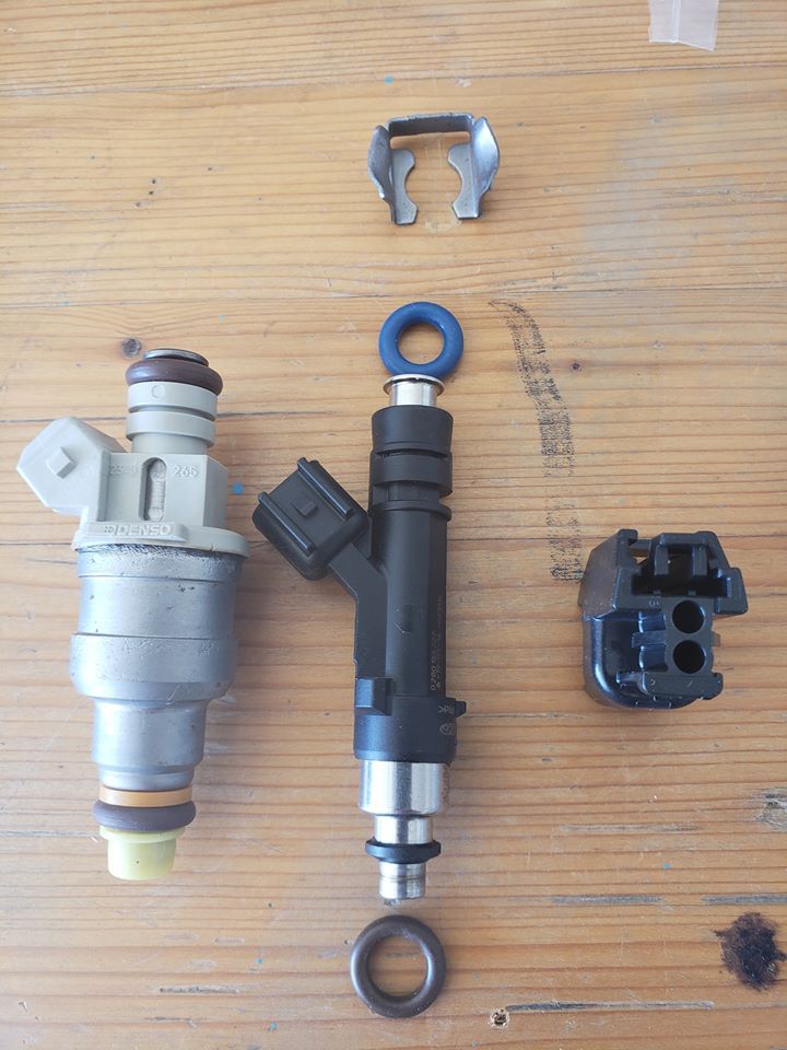

I went to 36# 2019 F150/Mustang FFV Injectors and USCAR Connectors - but this requires a tune and new connectors/adapters.
Even "Way Over Injectored" in stock form, the idle quality is SO much better than stock.

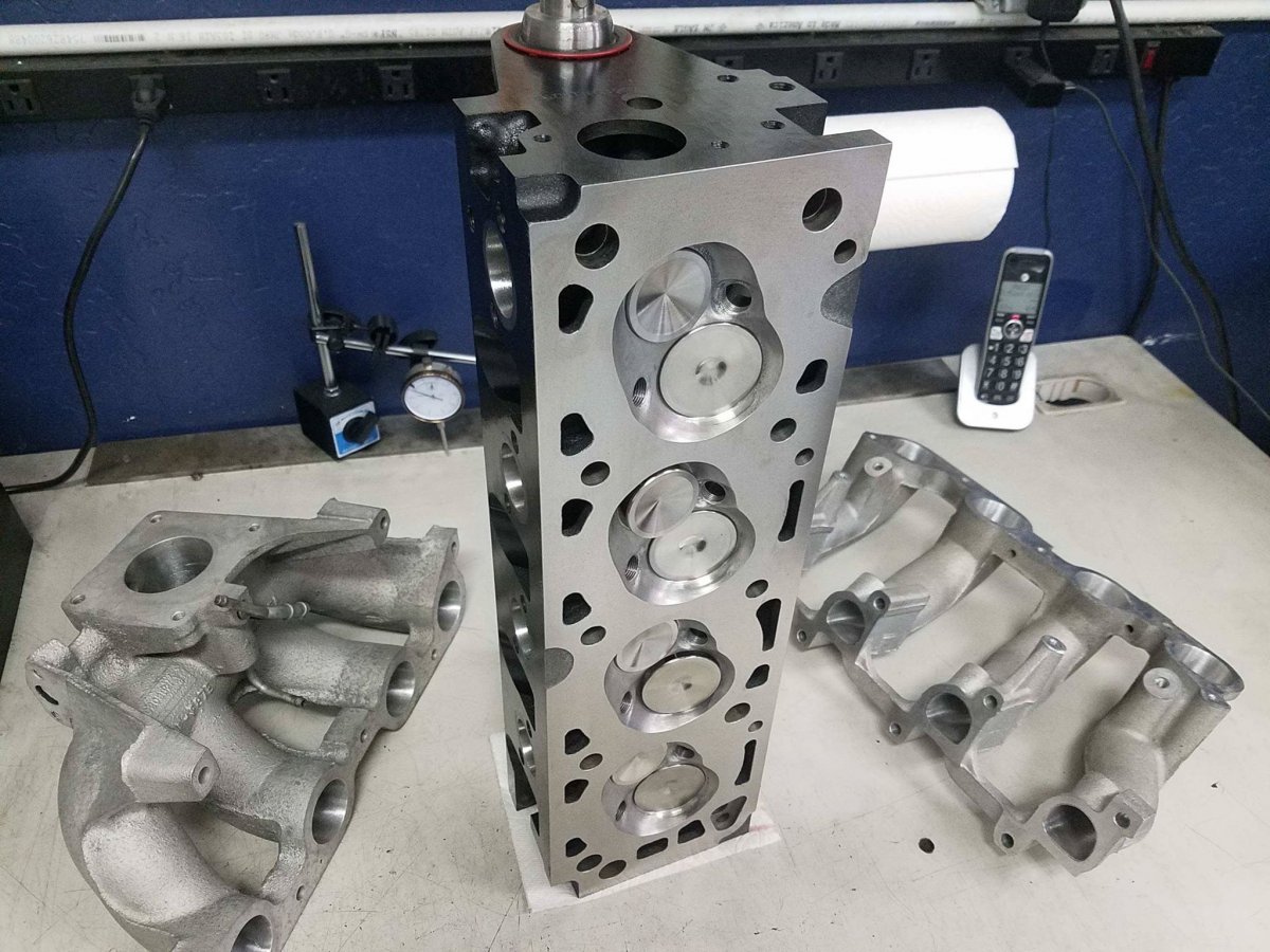

The thing to remember is 90+% of the HP potential of this platform is in the cylinder head.
You will need to make the vast majority of your mods there.
