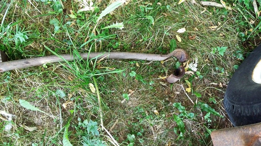

I started doing the rocker panel replacement and when doing the drivers side I had it jacked up on one side with stands.
I glanced over and noted the mono leaf spring at the front shackle was hanging off/down at a really odd angle. I figured the bushing went "Poof" and did a full inspection.
Bushing is still in tact. The mono spring where it curls around the front most part of the bushing has snapped in two! So I have 1/2 a "Hook" or a "Scoop/Spoon" holding the rear spring against the bushing. It's not falling all the way down and apart, when it's off the ground it looks like it's wedged.
Okay Okay... Clearly I'm not going to be driving around a great deal and going on the pot hole express. Plus with the weight on the back axle there's little to zero chance it will bounce up and out. However being the "Safety forth" kinda oddball that I am?
Need to replace it. I've planned out another day at the local yard. I'm not a fan of the mono spring.
Need suggestions on replacement.

Would either an Explorer 2001-2002 with a multi pack leaf spring, or the later year Mountaineer multi pack leaf spring be a decent idea for replacement?
Considering I have the 4.0. Rock auto shows the same spring replacement (not the mono spring oddly enough) Across all years. Except when I get to the 2002 with a V8. That only has one spring listed and is a different part number.
Would that mean I need to only use a 4.0v6 spring--And would any spring pack work? (I'd like to get the 4 door one, as they seem more popular and I would think holds more weight)
