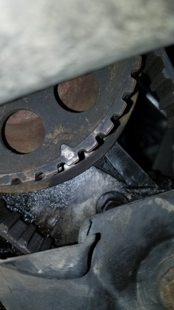

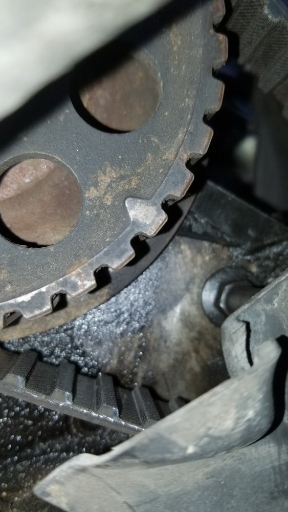

I was wondering about cam timing as well... From what I can see online the timing mark is on the backside of the plastic cover.... Sadly.... Someone cut the cover up...... And I can't find it and my cam pullie is pretty rusty.... Is there any alternative ways of checking cam timing?

I know there's supposed to be a little imprint on the very edge of the pulley but neither here nor if I rotate it 360 degrees can I find it... I also get quite a bit of missfiring/popping out of my exhaust when coasting in gear

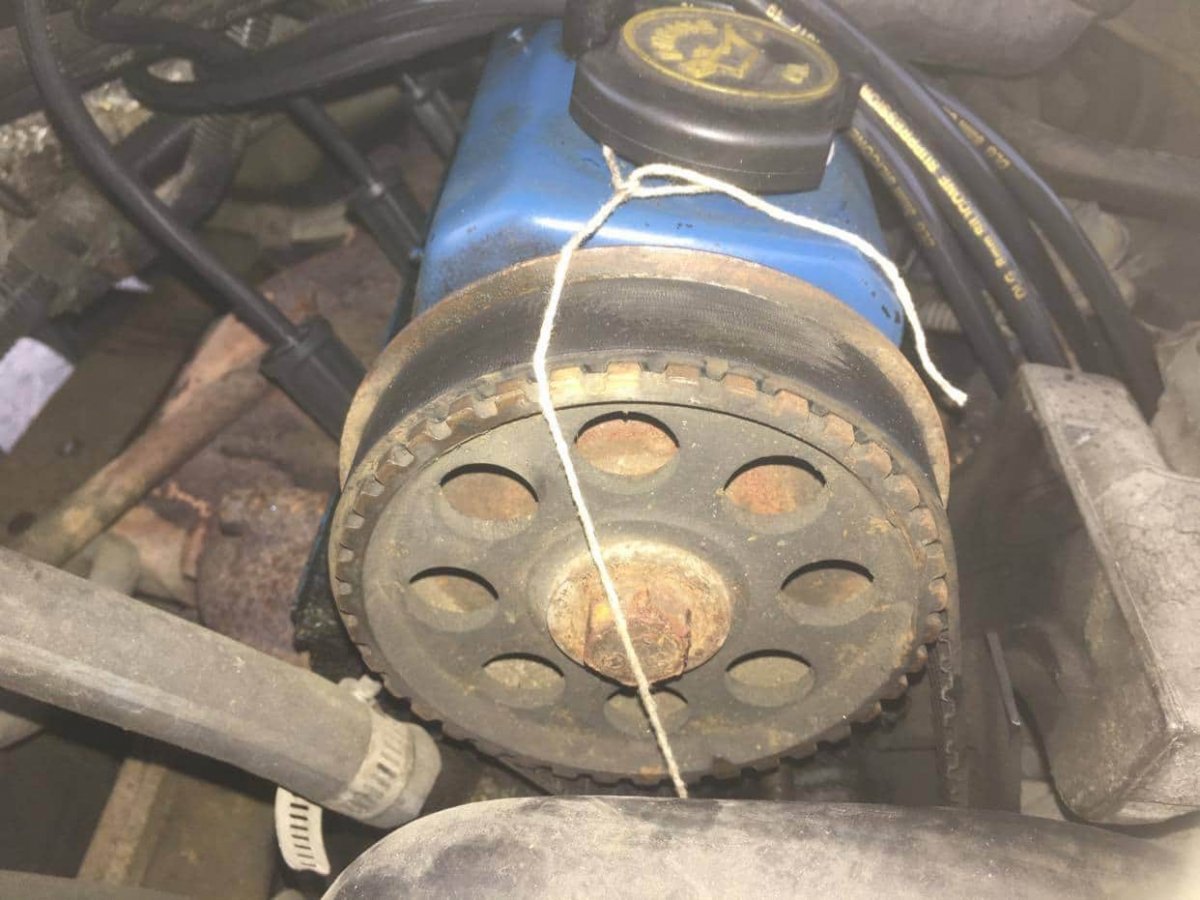

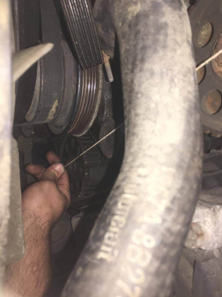

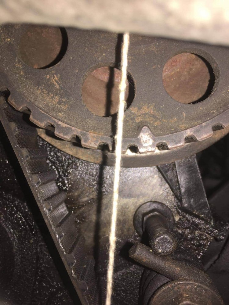

I just read another post on another thread about lining the the crank to tdc and taping a string to the center of the auxillary shaft bolt head and lineing it up to the center of the cam shaft bolt head and lineing the timing mark up to the string? Is that extra nub on my cam pullie the timing mark? If so I am one tooth off.
I just read another post on another thread about lining the the crank to tdc and taping a string to the center of the auxillary shaft but head and lineing it up to the center of the cam shaft bolt head and lineing the timing mark up to the string? Is that extra nub on my cam pullie the timing mark? If so I am one tooth off.

Also I redact that the engine idles "AMAZINGLY" without the spout connector it. It's definitely improved but not amazing. I got to listen to some 4 cylinder rangers near me at stop lights and they pur like kittens and mine more like a lumpy weird mess of bangs

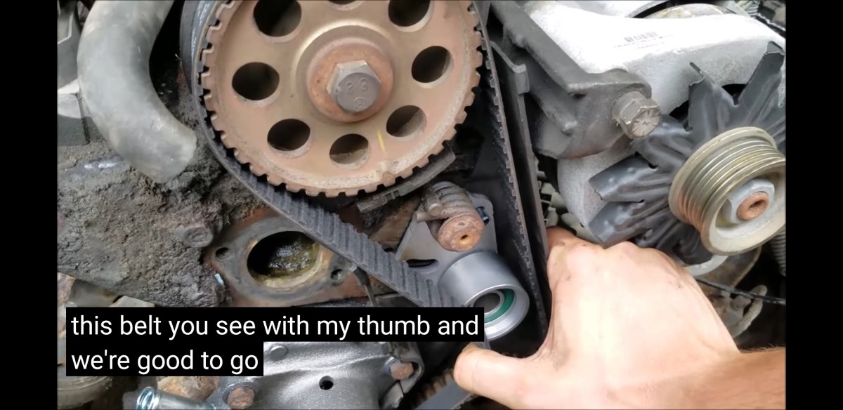

From what I'm seeing I just looked up a YouTube video on changing the timing belt and the image attached below is where his cam rest at tdc. If you look at it compared to mine then mine is exactly 1 tooth off!!!
