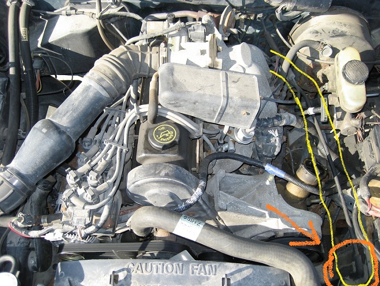

Hopefully this will help others. The truck has been miss firing since I bought it a year ago. I've done a full tune up, intake cleaner, injector cleaner, among other things. It was a 90 degree vacuum elbow off of what I believe is a emissions device of some nature . It now purrs like a kittin, has more power and my fuel mileage increased. :headbang:
Being under the hood of this thing a lot nothing appeared to be wrong with the elbow, but upon closer inspection it did have some rotting.
Ford wanted 80 dollars for the part, but I ended up going with a 2.99 part from a parts store that appears to be of superior quality. I honestly don't know the function of this emissions device, but it goes from the black box to the intake behind the throttle plate. If someone knows what this is please chime in.:icon_confused:

I believe that is the elbow for the charcoal canister. You are talking about the "orange" circled piece of hose that is blacker than the rest of the components, right?
Yeah, it's basically an overflow...that is supposed to let excess gas go, eventually, back to the tank...good to know it can cause a miss fire though...I'm sure someone will benefit from that knowledge...
No.
The charcoal canister is in no way an "overflow" nor does it send anything back to the tank. In fact liquid fuel will destroy it. That is why "topping off" the tank after the pump kicks off is a bad idea. It can force liquid fuel up into the carbon canister and ruin it.
It is connected to the tank and the intake manifold by vapor lines. There is another line connected to a valve (on some years) that allows fresh air to be drawn in.
As fuel evaporates in the tank the vapors move up the line and are trapped in the charcoal matrix of the canister. When the appropriate conditions are detected as valve at the intake (purge valve) and the fresh air valve (vent valve) are opened. The engine vacuum pulls fresh air into the evap system and as it passes through the canister it draws the fuel vapor out of the charcoal and into the intake so it can be burnt as fuel.
That is how the more modern ones work anyway. On a 94 the system is far less sophisticated but works on the same basic principles.
