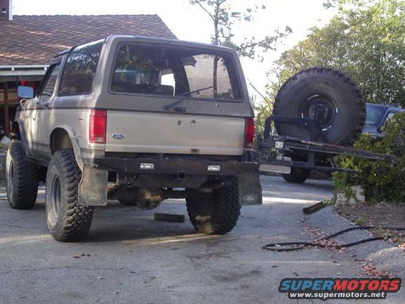

Shran… That hinge is bad A$$… and they sure don't give that thing away. I had a plan to use the 1" trailer spindle until I seen the one you posted. I think I'm gonna do some measuring this morning and see if it fits the new plan I fell asleep thinking about last night. I do have a question about how you mounted it... looks like you welded it to the top of the bumper and then put a gusset on it. Is that correct? does the hinge rattle while driving? At pretty much 5 inches tall without measuring my Ranger... it just seems like 5 inches would put that hinge at least partly in front of the tail light.
1x2" .120" wall is what I used for the carrier on mine. The main frame part of the carrier has held up fine, but a couple years into it's use I had the riser portion of the tire mount crack. I've since doubled it up with a 2nd piece of 1x2" welded up against it.
If I had to do it over, I'd use 2x2" .120" wall tubing for the whole thing.
Sorry, no pics of where it cracked.
Thanks for jumping in on this Junkie... Don't think I've seen your BII... nice truck man. I ended up buying 12 feet of 2x2 1/8" (or is it really 0.120"... I'm gonna gauge it) tube to use for my carrier. I've been looking at pictures online and there are a 1000 different ways to get this job done. Your design makes 1001 ways... lol. I have concluded that there is no wrong way to make one of these carriers. Well... I guess I've seen a couple and at least one youtube video that should be totally avoided.
Shran… I think I need to rephrase my questions to you. What I posted previously seems like I was saying you did it wrong... that is not the case. I like all the stuff you build and all the cool trucks you seem to bring home on a regular basis. I was "guessing" at how you attached the hinge because I can't seem to make out exactly what is going on. Also... I was asking if the hinge rattled... not because of the way you mounted it. With the trailer spindle... the bearings get preloaded to prevent up and down movement. Is this gem of a hinge you have quiet and just built tight enough that it doesn't rattle? One last question about the hinge... if you don't mind. Does the lock out pin come welded on the hub and aligned with the holes... pretty much already assembled?
I got what you wrote! Didn't seem like that at all.
The hinge is huge. It rides on bearings and machined spacers around a big bolt - it definitely does NOT rattle and it's very smooth. Plus with the way it's designed, you're not relying on a weld around the bottom of a trailer spindle shaft, the whole thing has to break off. And you can weld it in whatever orientation you want - you can attach it on the bottom like I did, or weld the back of it to the vertical face of your bumper, or make a channel for the arm to go in and mount it inside that, fully welded all the way around... the possibilities are endless.
The lockout pin holes are pre drilled but the pin itself is not welded on so you can put it wherever you want, so that it locks in the correct positions when fully open.
As far as positioning and the gusset - what you don't see is a piece of 2" square tubing that is welded inside the bumper and through a hole to the back of the hinge, plus a brace that is bolted to that and the frame, and the triangular gusset behind the hinge. I can still twist the bumper if I pull on the end of the tire carrier arm... but it's not floppy. It needed all the extra supports.
