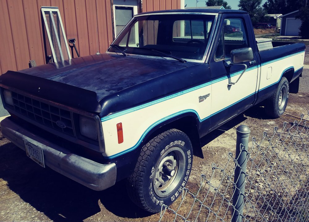

Truck background-- I went to an auction to buy a backup work truck, was eyeing a 68 C10. When I got there I saw this beauty. When I sat in it, I decided I must have it. Auctioneers claimed the truck ran with fuel in the carb, but wasn't delivering fuel. The truck had not been registered since 2000. I believe it sat in a barn the last 19 years or so. I got a little excited in the auction and ended up spending $1300 to win. I'm sure a few jaws will drop, but the truck economy is crazy here. Plus I really freaking love the truck and it's mostly in very good shape.
You see, my very first vehicle was a blue short bed 88 2x4 with a 2.3 and 5 speed. I flogged that truck endlessly in my youthful way. It stayed in the family and my wife bought/drove it eventually. Don't remember exactly why I sent it to the crusher, but I have regretted it since. Since then I've had two 94 Explorers. The automatic was trash, the manual was gold. (Still have the manual, Cleo is going to cannibalize it). Currently the work truck is an 06 Superduty with the 5.4. I used to think I was a Chevy fan.... but I always end up with Fords lmao.

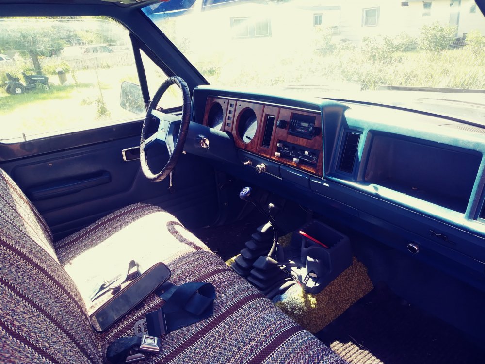

Truck is a long box 4x4 with the 2.8 and a 5 speed manual. Dual gas tanks. The inside is very clean. The undercarriage is very clean as well, underneath the fossilized cow shit, or whatever all the nasto is. Most of the body is straight and very little rusting. Fuel sending unit doesn't work, haven't investigated it yet. There is an AC button on the dash, but no AC under-hood. Instead it has PS.

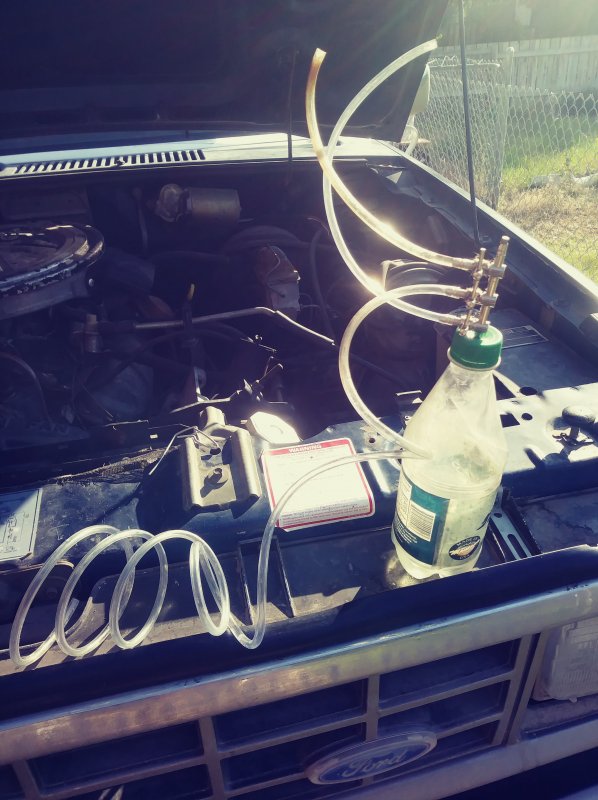

Got the truck home. An african carburetor helped me prime the fuel pump and a slow drip in the carb got it fired and the pump moving gas. ( They had already put gas in the front tank, no going back. Haven't touched the rear tank yet.)
