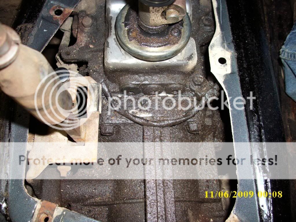

I changed the fluid in my 1994 2.3L, MANUAL, 5-speed OD transmission. Either by coincidence, or because of putting new fluid in, a leak began between transmission & transfer case. I can even see that it's deteriorated (can't see gasket between the two metal surfaces), at several places. So it leaks down and I refill as needed (every few weeks). It's run fine for several months this way, but I'm getting tired of it and want to prevent bigger, future problems, and stop dripping fluid everywhere.

first i would make sure that its the gasket thats leaking, these transmissions have a tendency to leak out of the 3 rubber plugs in the top by the shifter, which will then run down and cover everything. if youre leaking fluid between the trans and transfer case then you probably have a bad seal on the transmission side, since the two dont share their fluid (spearate fill and drain holes on both trans and tcase). you will have to remove the rear driveshaft in order to get the tcase off, theres no way around it. the tcase is light enough that you should be able to handle it alone, but another pair of hands wouldnt hurt either. once its off you can make your own gasket out of gasket paper, try to find one pre-made (good luck), or use silicone sealant to seal them.

I agree with ForOffRoadDriving, check those shift rail plugs, they leaked on both of the Ranger's I have owned and my coworker's.
the M5OD has a rear seal, there isn't fluid between the transfer case and transmission. If it turns out not to be your shift rail plugs, it sounds to me like your tail shaft seal is leaking, allowing fluid into that between space, which has a channel cut in the bottom to allow fluid out so you know its leaking.

you MAY be able to put the plugs in from the top, youll need to remove the seats and pull the carpet back to gain access to all the bolts on the floor plate. i used a socket to drive the freeze plugs in, and ill bet that if you cant get to them from the top to drive them in (not enough space to swing a hammer) you could use a wobble drive with extensions (not a swivel) and have someone hold the socket and plug in the hole from inside the truck, while you smack it from the bottom. you may need to lower the trans a little by removing the trans crossmember and supporting it with a jack (that will require removal of the driveshaft also). i used permatex aviation grade form a gasket, part no. 80019 to seal the freeze plugs.
