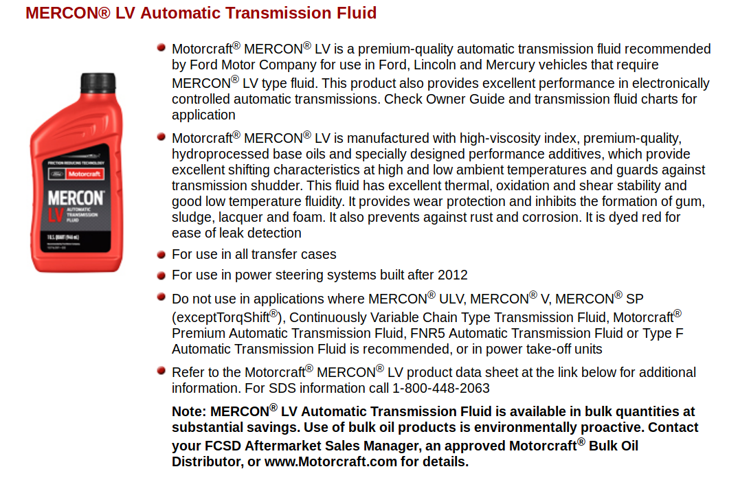

Wanting to take some time to finally change transmission fluid in the 1999 Mazda B2500 5 speed. I looked up the most recent forum on the topic and wonder if I can use Mercon LV?

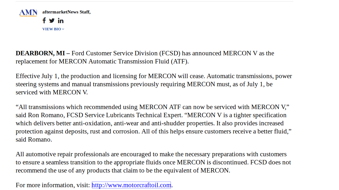

I know there was an update from Mercon ATF to Mercon V (a decade or so ago) and there is also Dex/Mercon<--is that the old formula? Can I use Mercon LV for the 5 speed change?

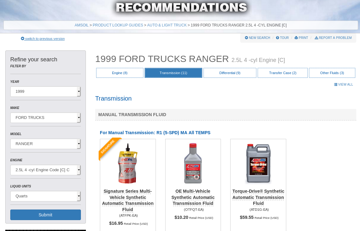

I should probably just go with Amsoil?
