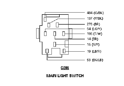

I need a picture or diagram of which wires go where on the main light switch not the dimmer switch on the column. I tookit all apart without marking them...
Thanks
Here's the pinout.
