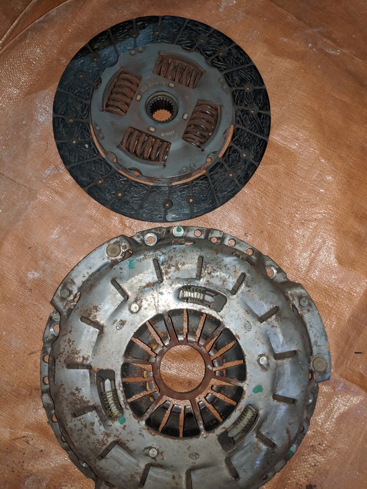

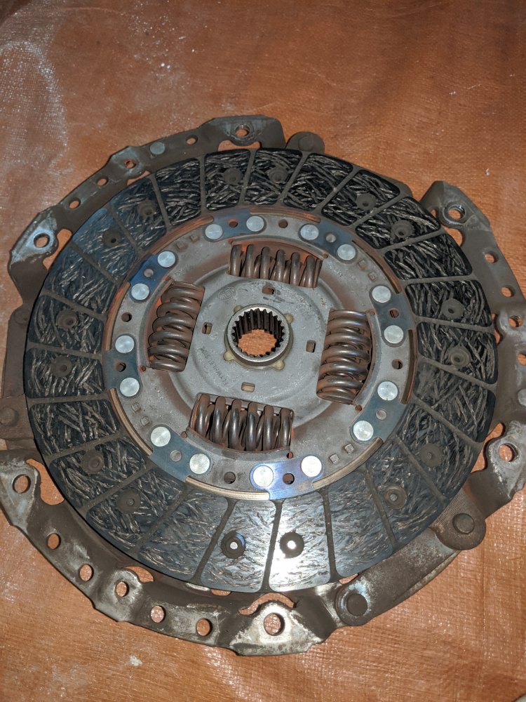

So I'm mechanically inclined but no real idea as to what I'm looking at. Just watched a bunch of videos before jumping in. The transmission was easy to drop.(only one I've ever dropped but not bad) got the clutch off. Don't know what I'm looking at but the Clutch looks fine and don't see any damage on the Pilate bearing. No leaking from the slave cylinder. Never had to add fluid so that was expected. The throughout out bearing has some play up and down and the new one does not but they aren't designed exactly the same. Does this clutch look bad to anyone or should I keep using it and just swap the pilot bearing for safe measure? Thoughts on the slave cylinder?

To the original thread starter; What does the flywheel look like? Fairly smooth with minor scratches? No cracks or blue marks? No worn down area where the disc was riding?
Hard to tell from your pic how much depth is left on the friction material on your clutch disc... I would suggest that if it's the original clutch, go ahead and replace it since you got everything apart. Things to replace: Clutch disc, Pressure plate, Pilot bearing, Release (a.k.a Throwout) bearing, Slave cylinder, and (if no cracking, deep scoring or heat discoloration) resurface the flywheel (but replace it if it has any of those issues). Many of these items (slave & bearings) are simply preventative measures since they do go out occasionally and are relatively cheap compared to the amount of work (or if you were paying someone, labor) it takes to pull a transmission. If you buy a complete clutch kit, most of these items will already be included (I recommend Luk for a replacement clutch or kit).
