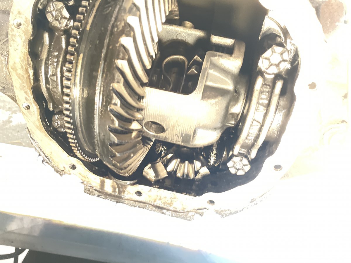

Then problem is in the differential
Put trans in Neutral, engine off and see if you can turn drive shaft with wheels on the ground, you should NOT be able to turn it even a little one way or the other
But in any case, drain the oil and open differential, I think you will see the problem

Differential is the problem

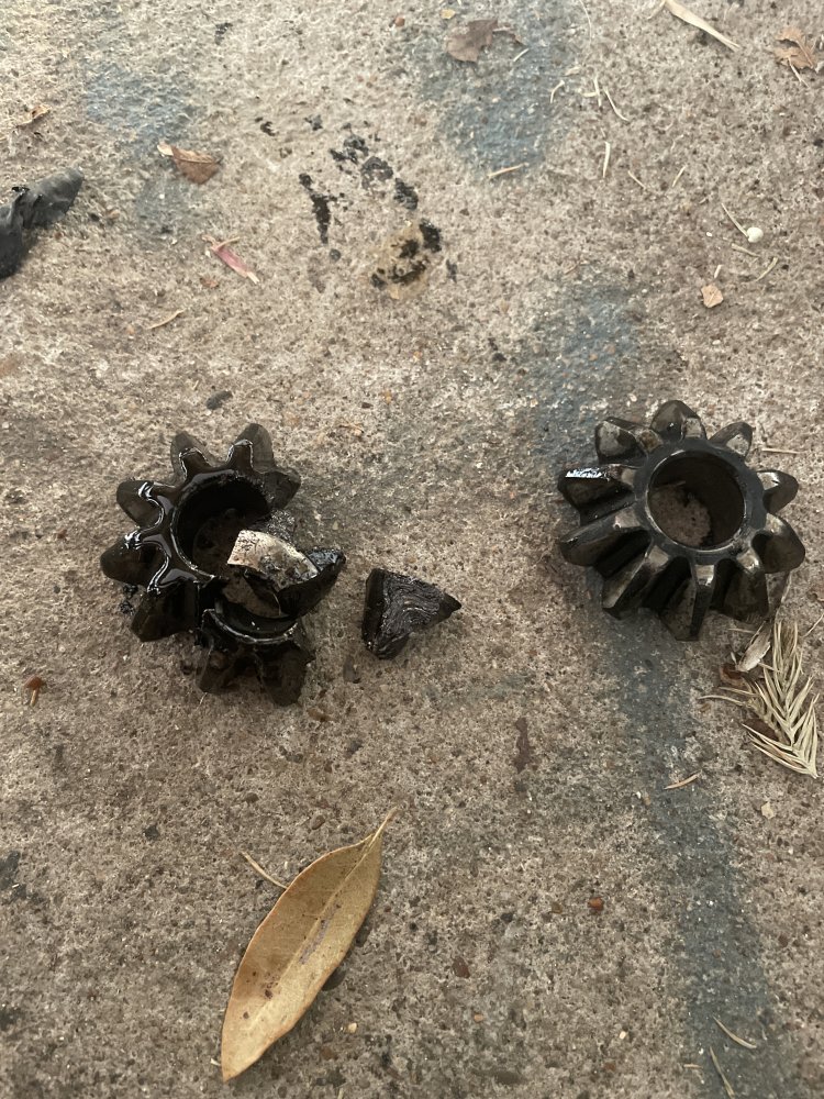

I have no idea what im looking at @RonD
Any help or plan or approach would be lovely.
Thank you

Doesnt Ford just make em like that for a reason? :)
No. :icon_rofl: Somewhere up in the housing, there should be a cross pin and the bolt that locks the cross pin in place. You should be able to find an exploded view of a 7.5 or 8.8 axle to see what it's supposed to be like.
Your best option, in my opinion, is to look up what axle ratio you have now and then buy the whole axle assembly from a wrecking yard

If everything else looked in good shape, I would clean the whole thing out real good, and replace the spider gears.
