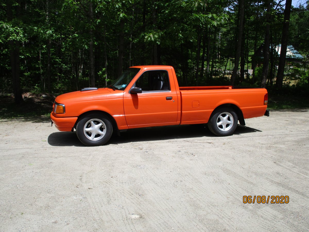

Depends on the lowering kit.
My 93 has dropped I beams and the rear end sits on the springs. When I looked at it to buy, it was in a car trailer and I didn't realize it was lowered. I replaced the axle pivot bushings and ball joints and stuck the dropped beams back in rather than try to find some stock I beams. With the dropped I beams, the alignment is set to factory specs, obviously except for ride height.
