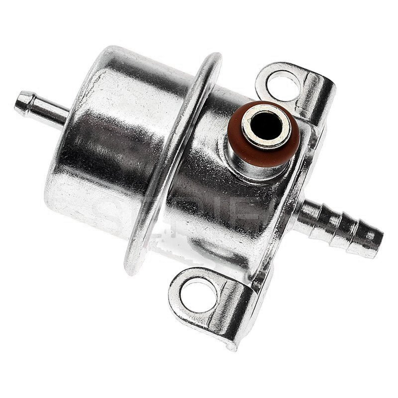

You seem to know your way around so dont take offense but the regulator looked like this right?
Yes, that's the one that was on the truck, and the new one I bought to replace it. The other has the vac line at a 90* angle. Turns out that injector is from some Toyota (doesn't surprise me, looked like it was wired by uncle grandpa...) I know a guy that has several of these truck just sitting aroind. Figure I'll see if I can get an injector and maybe the other style FPR

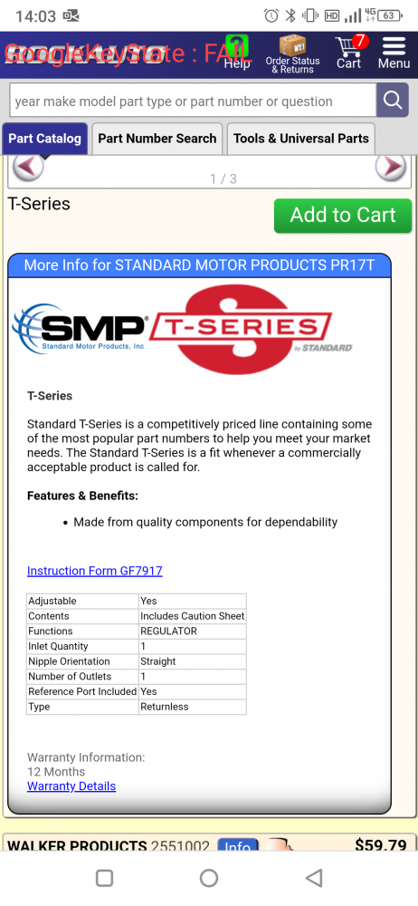

No 2.9 had a returnless regulator. Every Ranger had a return line up until 1998? or so? I'm sure you've got the right one and it sounds like it's more or less functioning correctly, the fluctuations are what gets me. I'd be curious to see what your vacuum readings look like at the regulator, do they jump all over with the fuel pressure reading? I did have a bad one on my truck that caused a low pressure issue, more proof that "new" parts don't always equal "functional" parts as it was only a year or two old.

This is a screenshot from rockauto, but every other part shows the same thing. Ill put my little vac pump on the regulator and match the vac with my gauge on the engine and see what happens!

Wut. I looked up a FPR for a '90 Ranger 2.9 and that is the only one that mentions "returnless." Furthermore, the other Standard part (PR17, not "T") mentions nothing about that.
I think this is a good time to mention that Standard brand "T" series parts are absolute junk in my experience. The fact that their description is wrong further reinforces my opinion.
