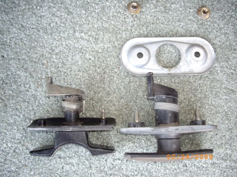

The handle with the letters on it is the BII handle. The other handle is off an Explorer. When mine broke I replaced it with the explorer handle.
Just drilled out the mount holes so the new handle would fit.
Found both at a local wrecking yard for a couple of bucks and about 10 min. work.

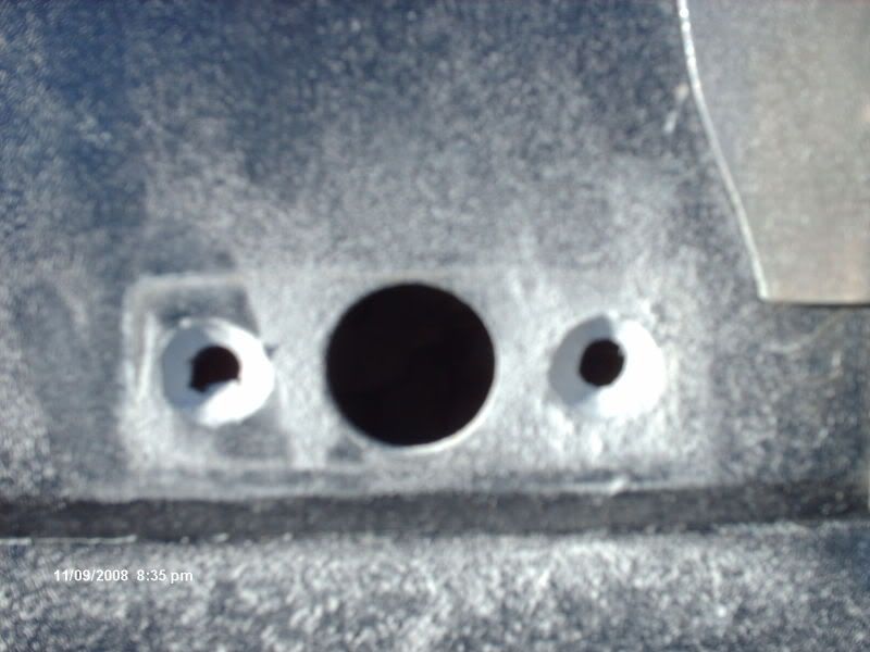

Old post I know, but facing a similar issue with my 88 Bronco 2. I pulled a handle assembly from an explorer but apparently too new of an explorer as my bronco 2 doesn't have any other holes in the handle assembly other than the large center hole. So now what?
You can open up the hatch, take the handle off, and shim it with a washer.
I had a write up about doing it on here once upon a time, but the pictures were lost in the photobucket debacle.
Mine is far beyond a simple washer repair. The internal piece that retains the spring broke into pieces.
I thought I read somewhere about being able to use an Explorer handle mechanism but apparently I was wrong because the Bronco 2 is missing 2 holes on either side of the center hole for that to work.
If only we had the technology to make holes in metal.
Rust makes holes in metal. Just wait a while.
Err you mean fiberglass, the rear hatch isn't metal LOL.
I assume that using the backing plate just mark the holes and drill them out for those 2 side bolts, then the rest would go together the same as the original Bronco 2 latch release mechanism was?
