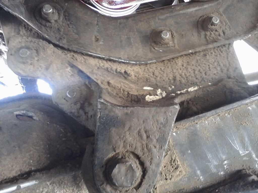

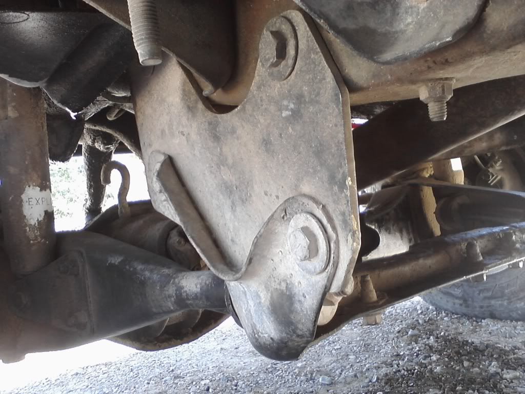

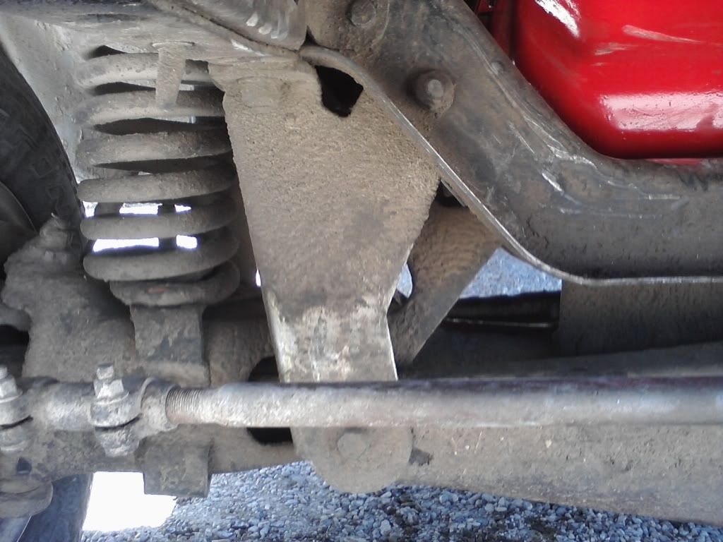

Well the coils are actually F150 coils that are sagged to all hell as you can see in the pics. The PO swapped out F150 coils and apparently put in the drop brackets. I will take the measurements tomorrow. Its dark here.

It looks like you have a RC 4"lift already, as mentiond above get yourself some decent bump bump stops (so you don't put ANOTHER hole in your diff). Look for some extended radius arms and some new springs and shocks should do the trick all around.
