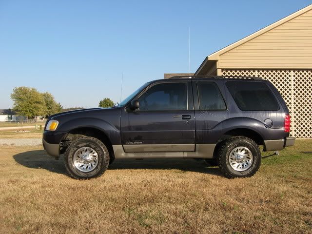

Hey there!
I’m hoping you guys can help me out. I have a 2001 Explorer Sport with a sagging rear end. I saw the post about changing the leaf springs on a Bronco II to a 4 door Explorer model. What years will fit my 2 door Sport. I have also seen a post on another form where they mentioned an F150 leaf Spring set up will fit. Is this true? What about ride? What ride height can I expect. I just want the thing to sit level.
Thanks for the help!
Rick
