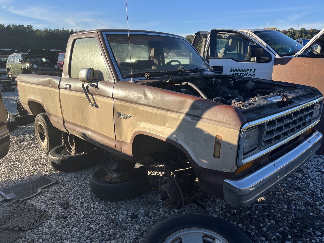

Took a Tuesday afternoon stroll through the junkyard, as most employed people do...
Saw this little gem parked in the back corner.

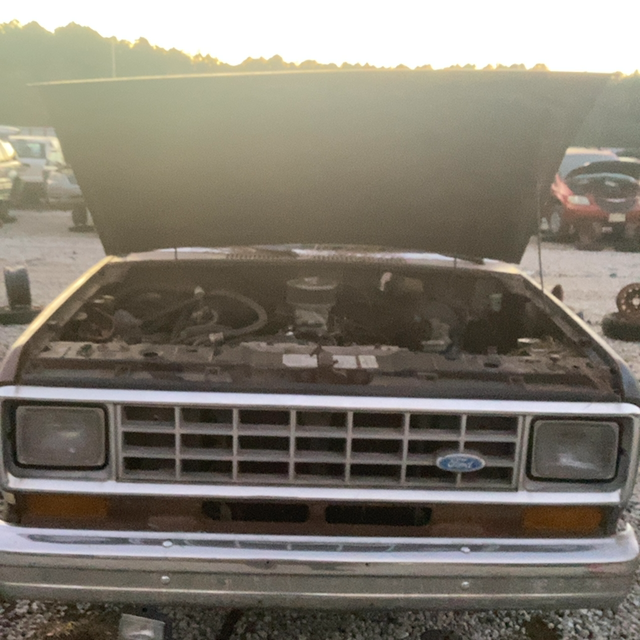

The un-stock air cleaner piqued my interest but I'm not knowledgeable on the 2.8.

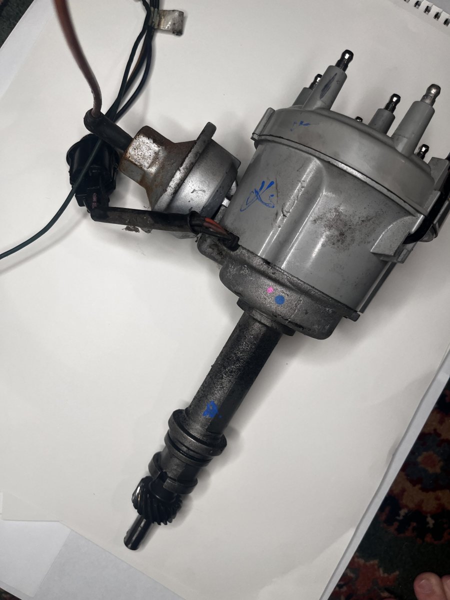

I'm asking for some more seasoned eyes to confirm if this is an attempted Duraspark conversion..
Couldn't find much info on the bits I pulled. Most the wiring had either been yanked, cut, or was missing by the time I got there which raised the Duraspark question.
Someone before me clearly attempted to get these parts off but probably couldn't free the retainer bolt for the dizzy and gave up.
Distributor is a Motorcraft 75TF 12100 NA 4JD

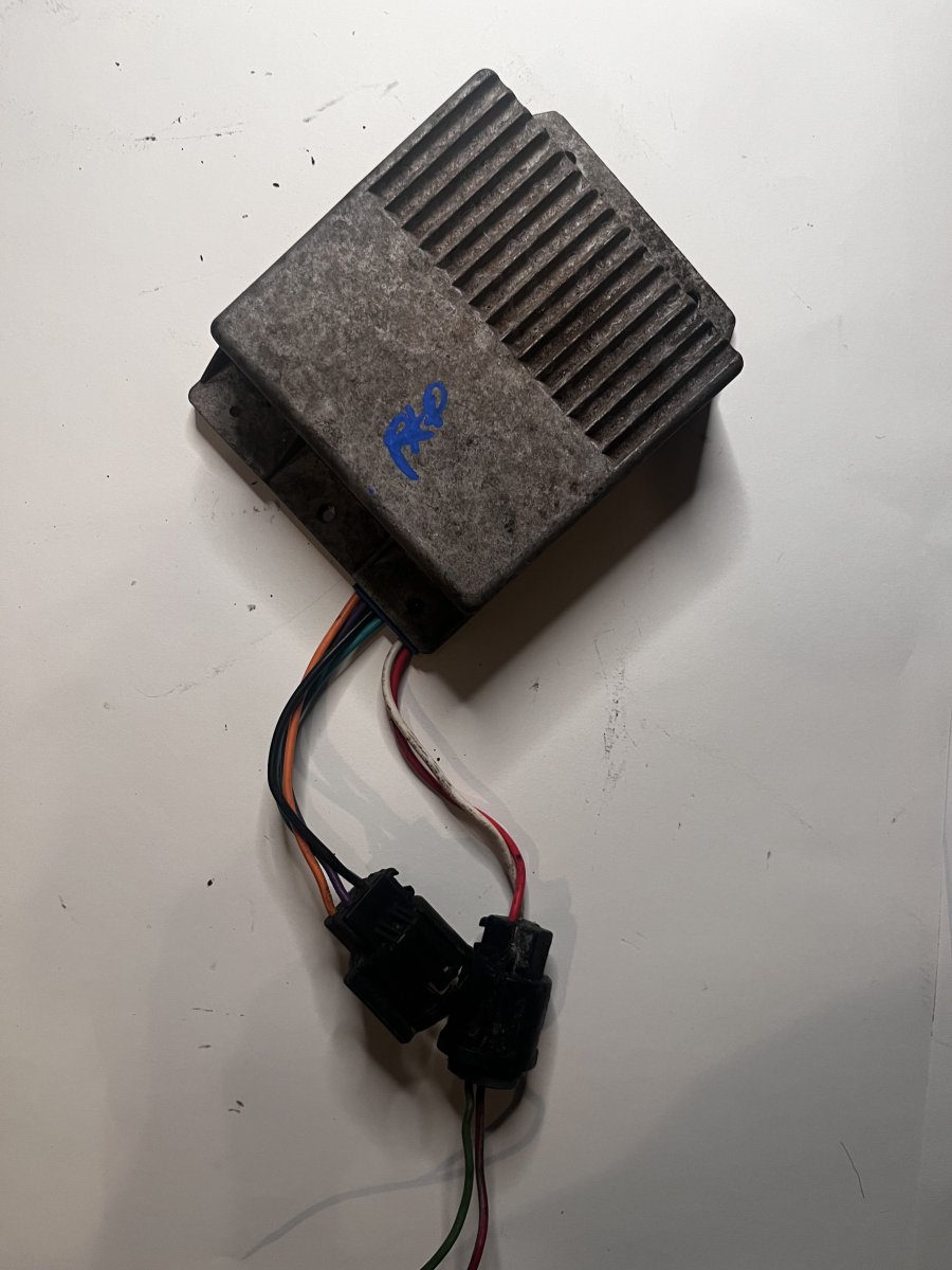

Ignition Module ID# M50 52405

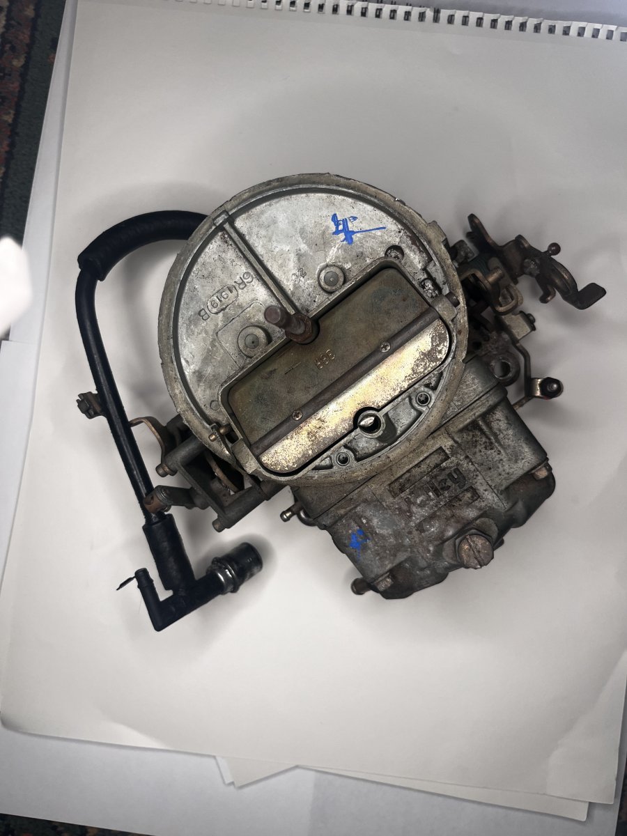

Carb is a Holley 2 Barrel 6R1919B

Those parts are in very high demand. You can't get that distributor anymore from the reman people. That is a duraspark II distributor, see the vacuum advance where the vacuum hose goes? That is all old school. The original TFI distributor just has a flat grey module mounted to the distributor with no vacuum line connection.
Does the module say "Motorcraft" on it? Those are the best modules to use also.
The carb looks like it is a center hung float aftermarket Holley. That is a nice score also.

The module says Delco, not Motorcraft.
