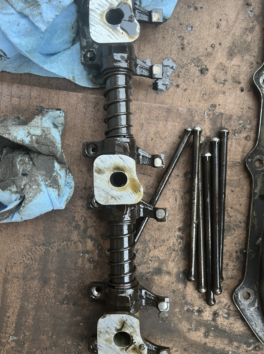

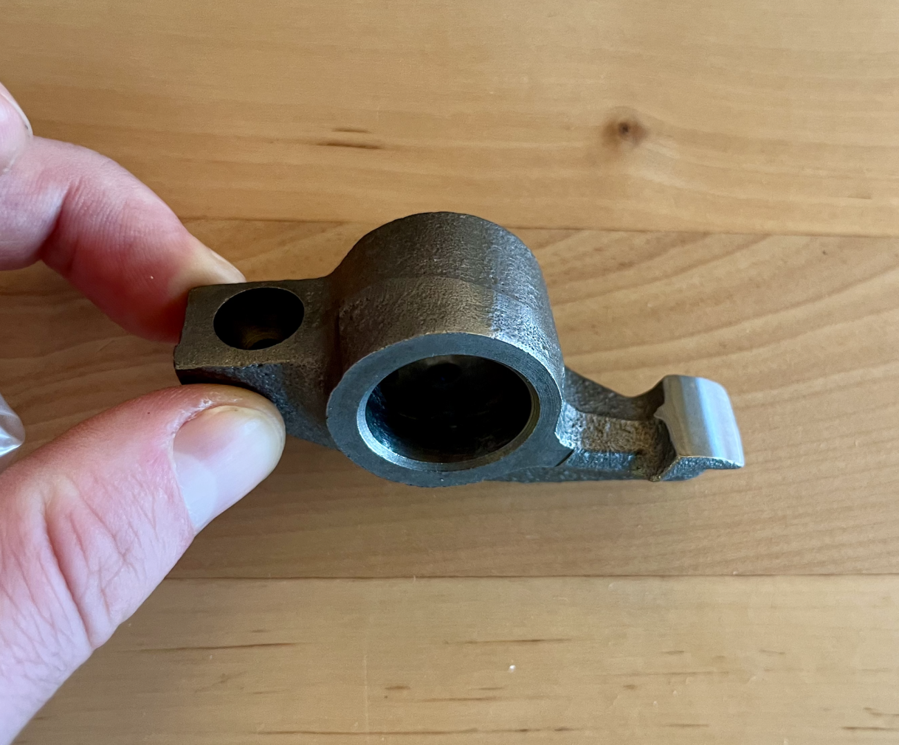

Here's a pic of the wear on the rocker arms of the engine I swapped in.
Be careful driving the pins out of the ends of the shafts. It's REALLY easy to mess up those little spring clips.
Nice. I'm guessing my rocker arms will look similar. Excited to share some pictures when I have it out. The video I attached in my first post has a guy show exactly how to take the pins out, and which tools. But he of course made it look "easy". So I'll take caution. Thanks for the warning. I'll follow your advice and change the oil after swapping.
Did you use anything to clean the sludge/buildup on the assembly?
Dropped em in the parts washer at work. Since it's all metal, I'd use brake cleaner at home. Mine still fought coming apart but I just used a small hammer, punch, and couple chunks of 2x4.

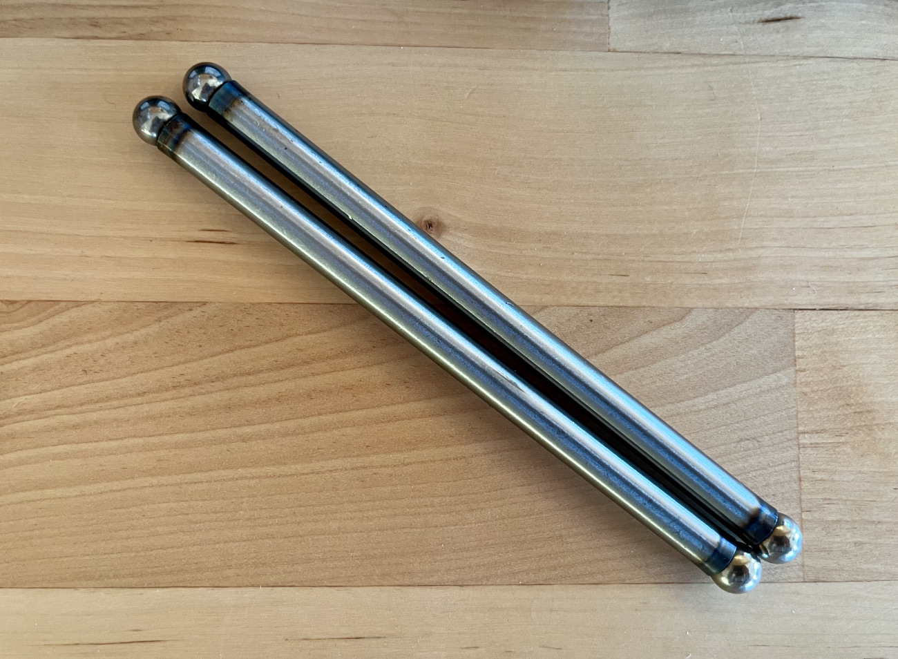

12x pushrods just arrived. I'll double verify that they are the correct length versus original pushrods upon installation.

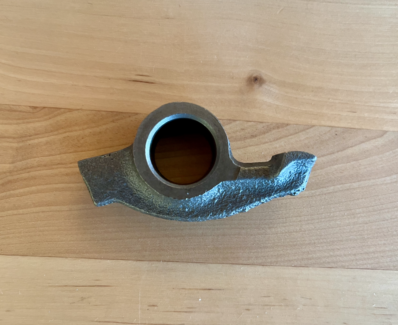

12x rocker arms also just arrived. I'll visually compare new versus old ones upon swap.
Both made in USA, EngineTech brand. Seems quality.

That's the way I'd do it. Yes that means some old oil is gonna run on/thru new parts, but if you do drop a little crud into the engine it'll come out with the oil change.
I never heard the engine before replacing them. I bought it from the junkyard that way. I will say it made an AWFUL noise for about 15 minutes after my 1st startup.
Nice. This one is running fine minus the tick. So we'll see what the rocker arm/pushrod swap accomplishes. Tick is likely either worn rods/arms or old lifters.
Curious whether this wear was causing a tick. And if replacing them fixed that. (That's my goal with this swap).

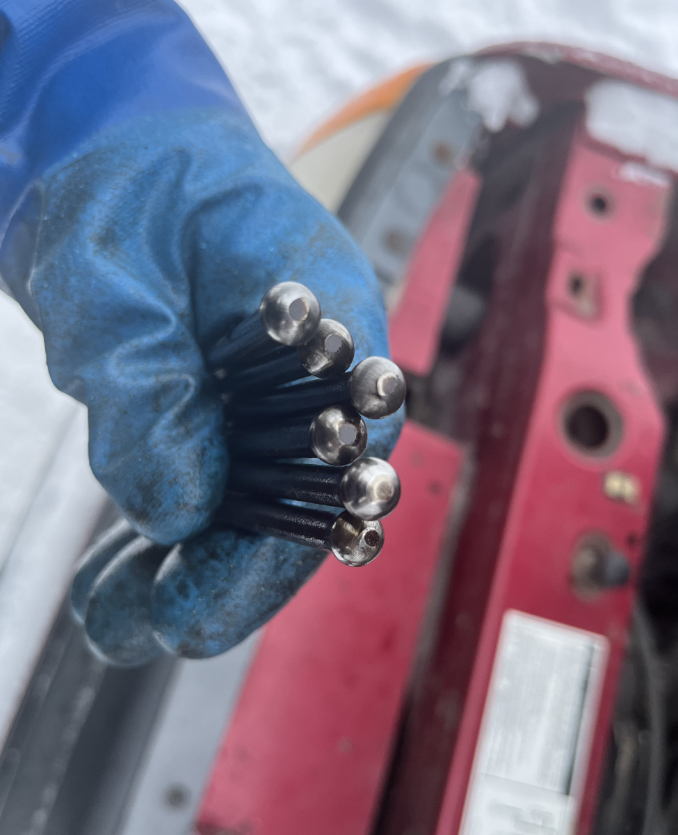

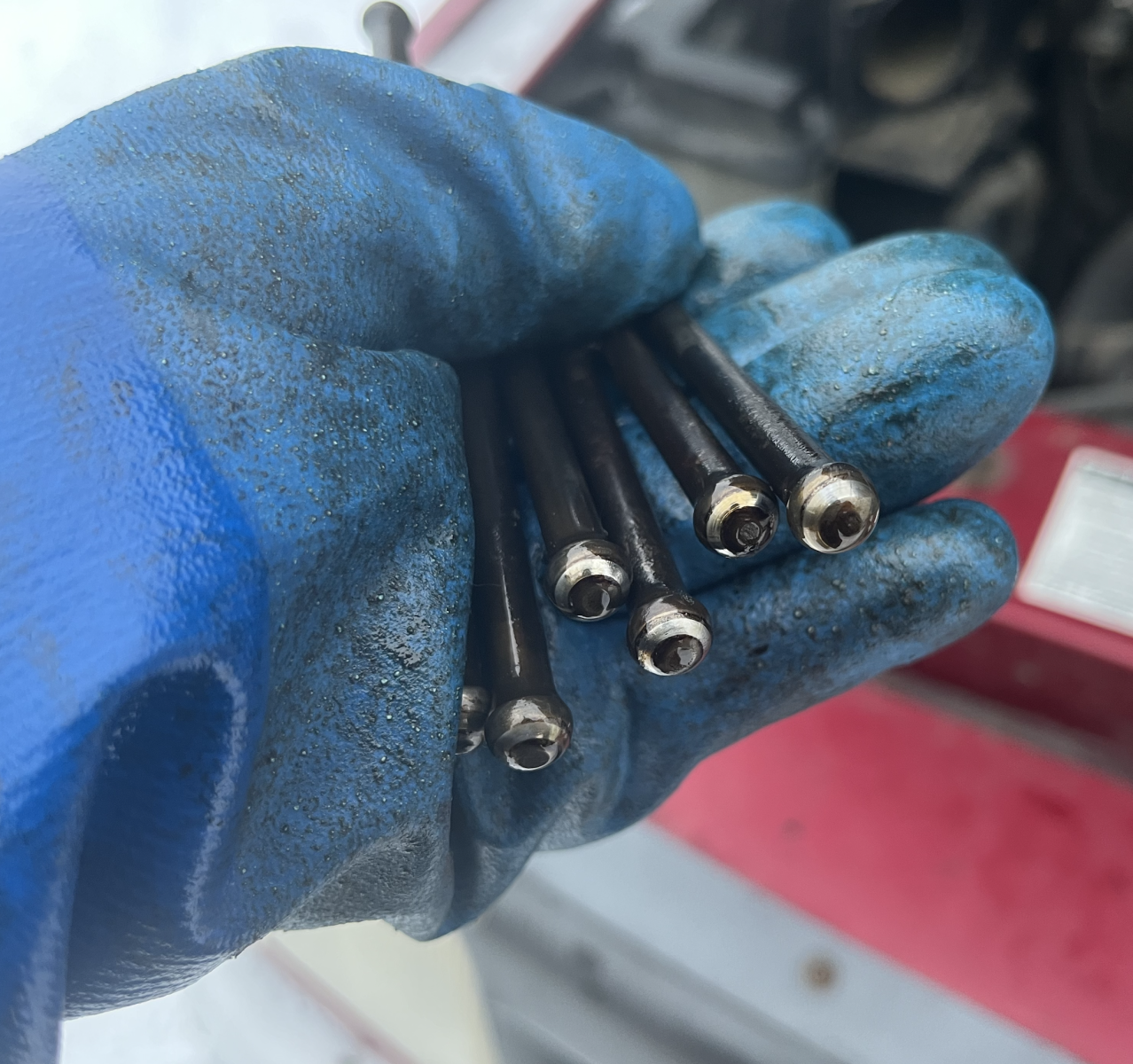

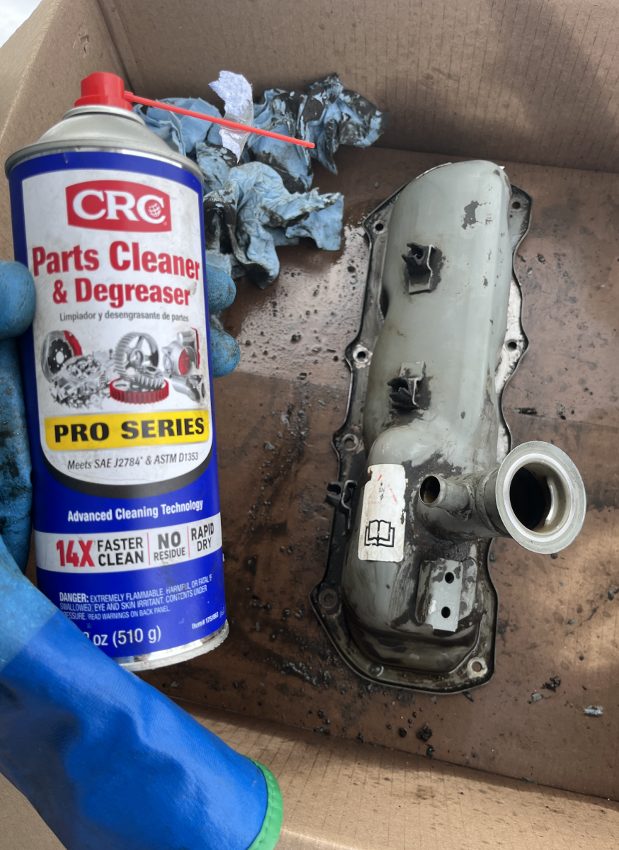

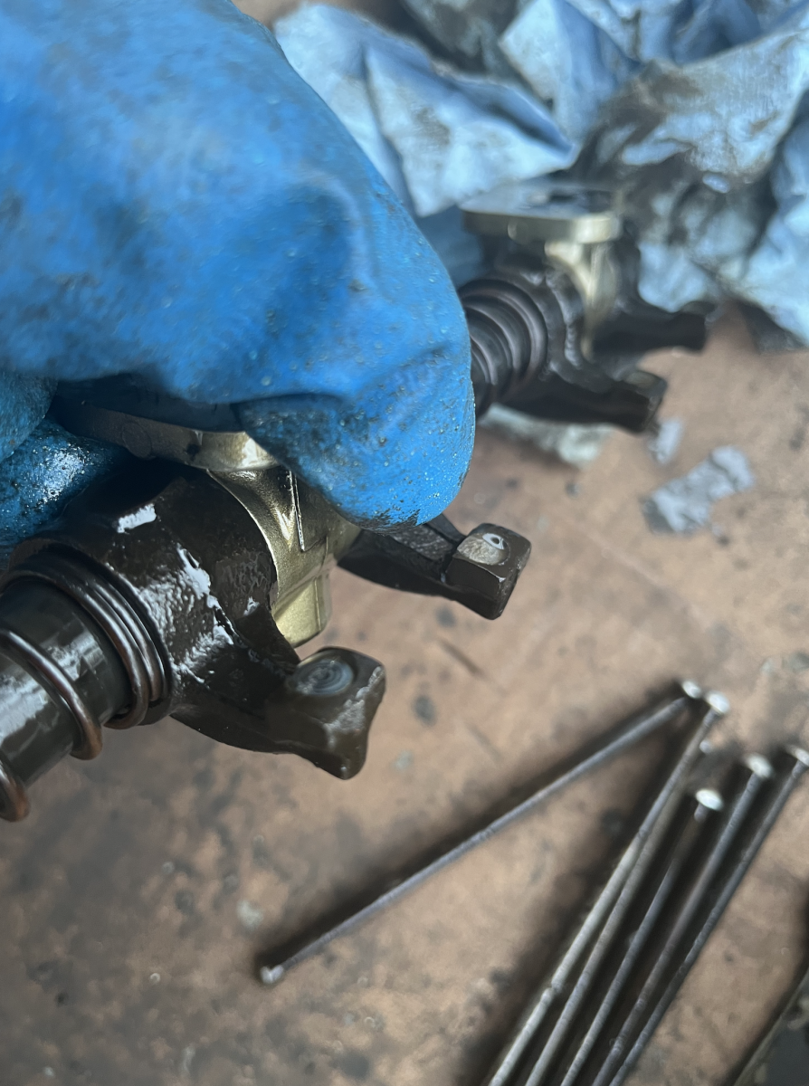

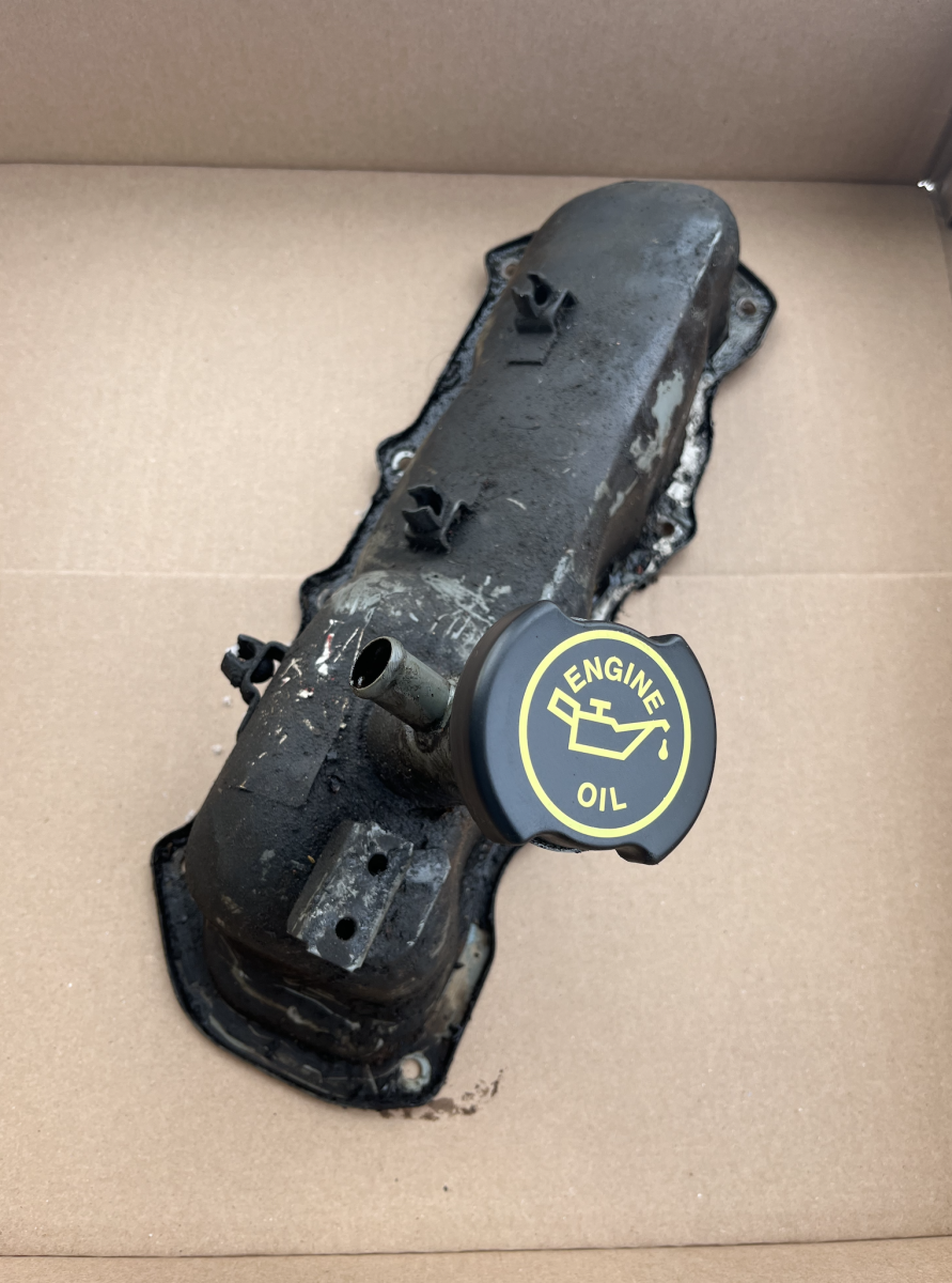

I'll update with more info. But essentially removed all electrical harnesses, vaccuum tubing, and alternator. Got to valve covers. very difficult to get off, but took 8 bolts off (which were somewhat loose after spraying penetrant) and then heat gunned (hair dryer'd) the cover til I could rock it off.
15mm bolts on rocker arm assembly required a large makeshift breaker bar. Then removed each slowly, equally since it's under load. Honestly didn't look too bad sludge wise inside. But clearly some wear on the arm pedestals, and some wear on the rods. Wondering if you guys think that could have been all the clacking ive been hearing since there is likely now some travel between these components. This seems like a common issue for these engines (read: https://www.broncocorral.com/tech_library/ford-ranger-explorer-4-0l-v6-engine/).
I'll replace rods and rocker arms on this side, then work on the driver's side for the same.
Any tips or thoughts at this stage would be very appreciated! I haven't inspected worn rocker arms or pushrods before, so tough for me to gauge the level of wear.

I guess a question I have is whether I should do something with the valves as well, as there was (probably?) some wear on those since they made indents on the rocker arm pedestals. I don't want to replace rods/rockers and there still be some play do to some wear on the valves. But also don't really want to do that if not necessary obviously.

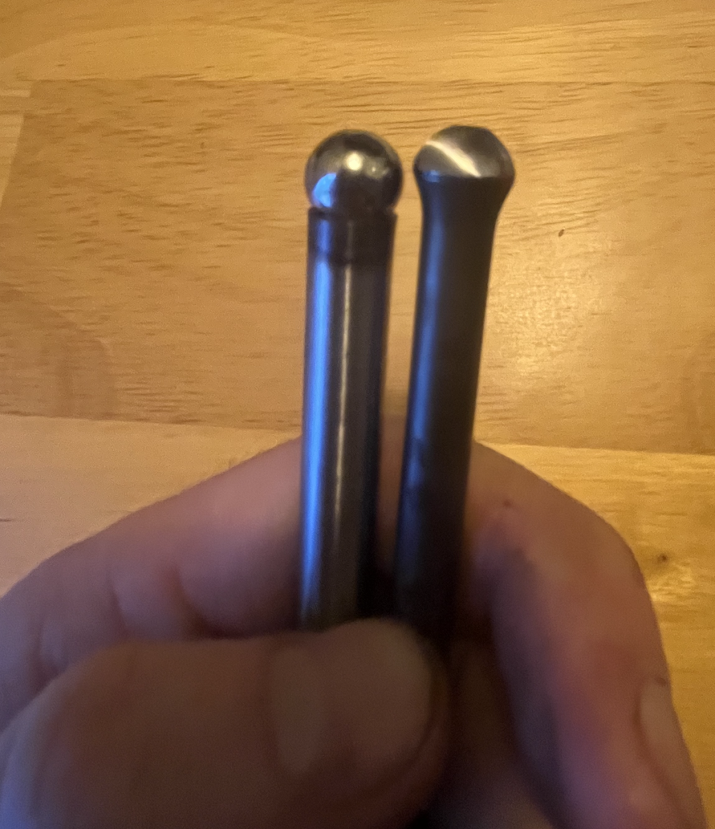

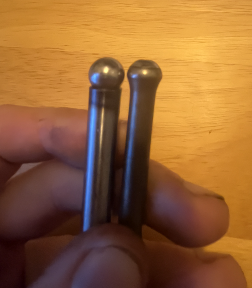

old rods definitely look "flat" on each end. new rod on left for comparison.
