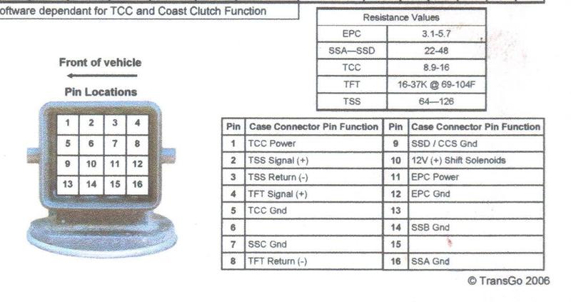

I would first test the wiring before dropping the pan
Unplug the 16 pin connector on driver side just in front of the shifter
Then print this:
Use OHM meter on pin 10 and pin 14, solenoid B(SSB), should see 22 to 48 ohms if its OK
If it tests OK then look at the pin 14 wire on the truck side plug, see if it got pushed out or back so can't make good contact
If pin 10 was the issue all 4 solenoids would set codes
You can test SSA, SSC and SSD just to make sure OHM meter is working OK
