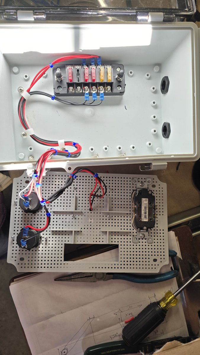

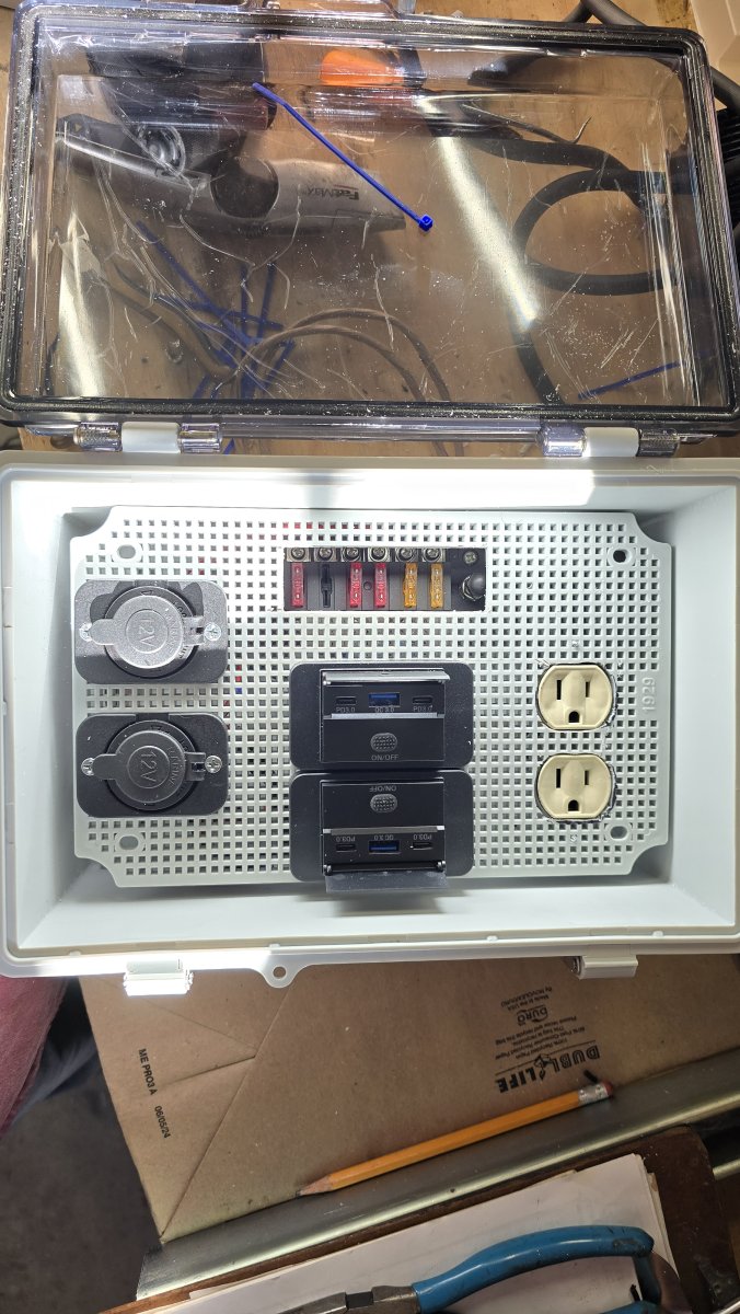

I started learning electrical stuff as a little kid in the 70's. Dad taught me to pay attention to detail and put forth my best effort. Is all my electrical work neat and pretty? No. Sometimes the job has to be done a bit quicker or finances don't provide the fancy pieces and parts. But I do enjoy electrical wiring and trying to do my best.
Just put this together today. It's going to be a power station for overlanding. When finished, it will mount on home made drawer slides under the bed, right behind the cab on my Ranger. It contains;
  • One 120VAC duplex outlet
  • Two USB power hubs including USB A and USB C ports
  • Two 12VDC power ports.
Should give me a place to charge camera or power tool batteries, run a laptop, plug in my air mattress pump, etc.

There's always a cost to build to, my overland trailer build vs my truck is a good comparison, the trailer is quite serviceable electrically but isn't really designed to take on being dunked in water, the parts selected for both, along with where things are located reflects these differences. I'd say that panel you're building looks quite nice and should serve it's purpose quite well. Is that a water resistant project box or something repourposed?

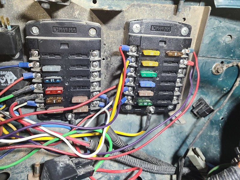

What's the upgrade you're planning?
I currently have Deep Blue Sea fuse panels. They work fine but the footprint is huge and they force relays to live wherever they can cling to something solid. Kind of a spaghetti pile. One is battery constant and one is key power.
I used one of these for my efans that wasn't prewired to set it up so they would run with either the A/C or engine temp and really liked it. Not waterproof but compact and lots of capacity.
Amazon.com: RVBOATPAT 12 Volt Fuse Relay Box Pre-Wired Fuse and Relay Box with 4 Relays and 12 Way ATC/ATO Fuses Sealed 12V Relay Fuse Box Block for Auto Car Marine Boat : Automotive
So I am going to have one of the prewired ones and one I wire myself.
