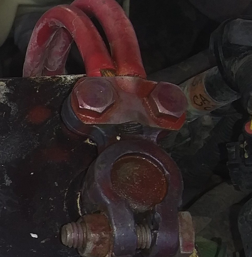

Looks like I have this fixed. A little embarrassed to admit it but for the good of mankind:
I was under the hood the other day for something else and noticed the positive 'fix-it' battery cable adapters was corroded. This picture is after I cleaned it. These were on the truck when I bought it a couple years ago, along with a new battery. Anyway so after cleaning, the radio has been working fine. And after I bought the little tool to remove the radio. At least I never got a chance to use them.
It seems odd to me though that the only manifestation of this was the radio. Still started and everything else was working fine afaik. There are two big cables, maybe one goes to the radio lol.
