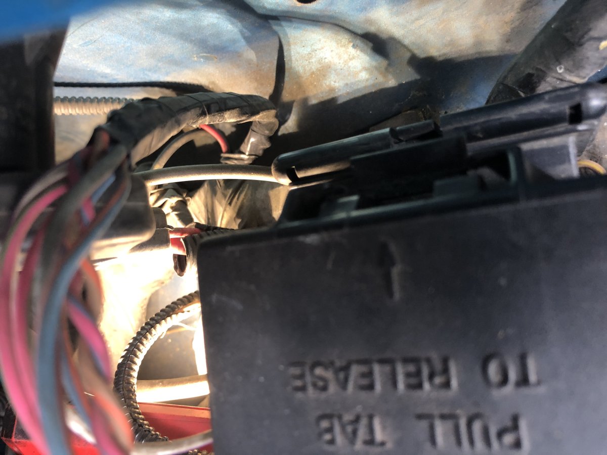

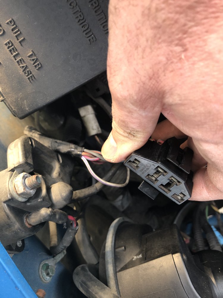

Hey while I have your guys attention, any idea what this plug is for? It's on the DS near the underhood fuse dist box and goes into a main wiring harness There was never anything plugged into this and i can't figure out what it's for. Could this be the reason I have no cruise control by chance?
Diagnostic connector. If you get an OBD1 code reader, that's where it plugs in.
Like Robbie said, that’s your diagnostic test port. You don’t have to have a reader. You can use a test light. You can also use a jumper wire and read codes with the CEL on the dash. One port on there can be used to energize the fuel pump relay for testing. There is more info in our tech library.
