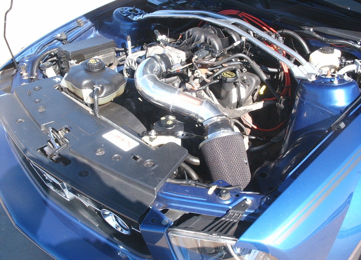

I pulled the plugs and they all looked identical. Did notice that when I pulled two of the plug boots, they didn't make that click. It's possible that I didn't fully engage those two wires onto the plugs, causing intermittent arcing and the miss. It didn't do it a lot, only occasionally. When I put the wires back on the plugs, I made damn sure I felt that click that signifies fully engaged. Problem gone. They're JBA full metal spiral wound wires. The ends are a real bitch to get on the plugs. Ended up using a pair of needle nose pliers to pull the center out of the boot. Put that on the plug and forced the boot back over the plug.

Been driving it daily, as my Ranger is still in the shop getting the 4.10s and shift kit. Hope to have it back soon. It's running great. Doesn't as of yet, have any PD codes showing. It would have by now, if it was still a problem.
