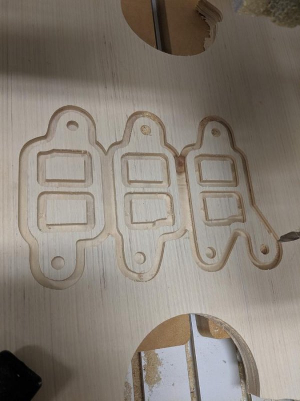

Buddy of mine picked up a flatbed CNC. I'm itching to see what I can make on it.
Haven't been able to find phenolic spacers for either a ranger or Scorpio intake (they are different), so considering knocking out a few spacers on his machine (these would fit either).
McMaster Carr sells G-11 grade garolite/phenolic. Spacers would be 1/4" thick.
If I can get a few takers, I'll knock an extra set or two out.
Would be asking $35 a set + $7 to ship.
Leave a comment if you're wanting a set.

Made some plywood ones while we're waiting on the right end mill.

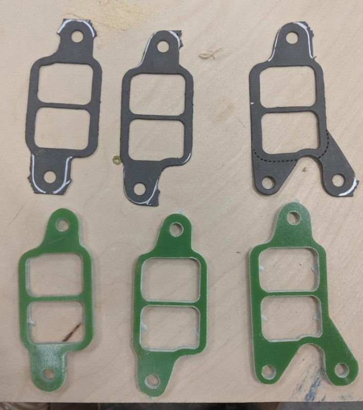

OP DELIVERS:
Fel pro gaskets top, G11 Garolite spacers bottom.
Ya'll know I'm dumb, and sorry for intruding, BUT, what are these, and what do they do?
Hey, you only learn by asking, right!?
These spacers are made of a material that doesn't transfer heat... So they're basically insulators that keep engine heat from radiating to the upper intake. A cooler upper intake means cooler air coming into the cylinders, which equals more power.
