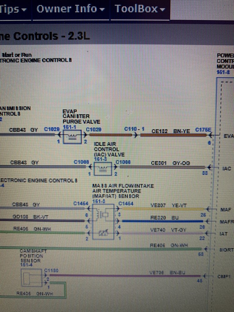

Intake air sensor is integrated into the MAF, cannot be separated.

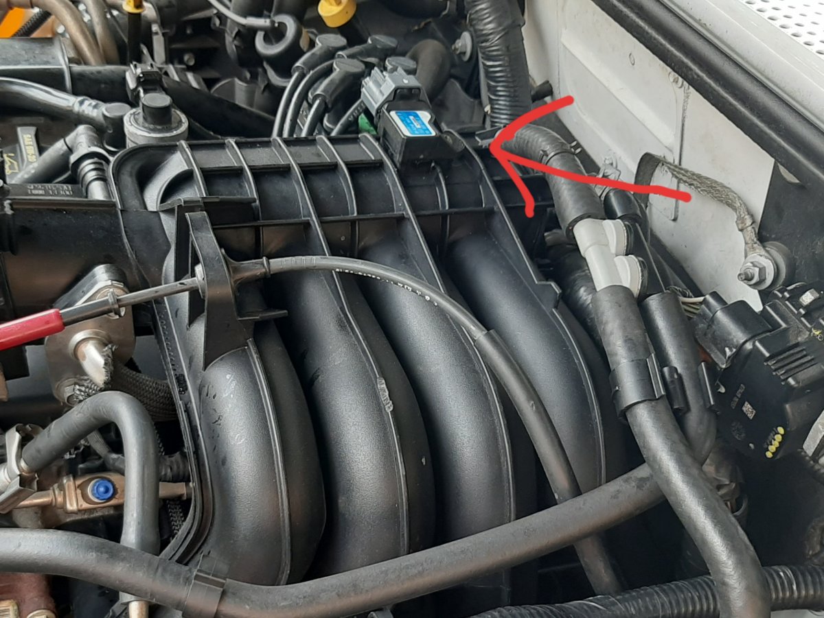

Map sensor is on top of the manifold. It definitely uses both a map and a maf sensor.
Both the MAP and MAF are 4 wire... so now im really confused. Thinking maybe the MAF is the ambient air and MAP is intake air? They are two different readings on my scanner.
Ford says your MAF sensor is 6 wire... that means the IAT is built in.
43814
yep, just looked. I have a 1S7A 9F479 AB map sensor on top of the intake. strange (really?) that my 2000-2011 Chilton doesn't mention it.
Hmmmm ok then so MAF it is... it definitely seems to be reading too hot then. 50 degrees over the ambient outside temp seems high when the MAF is well away from getting heat soaked by the engine.
