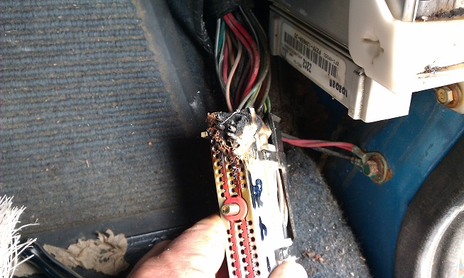

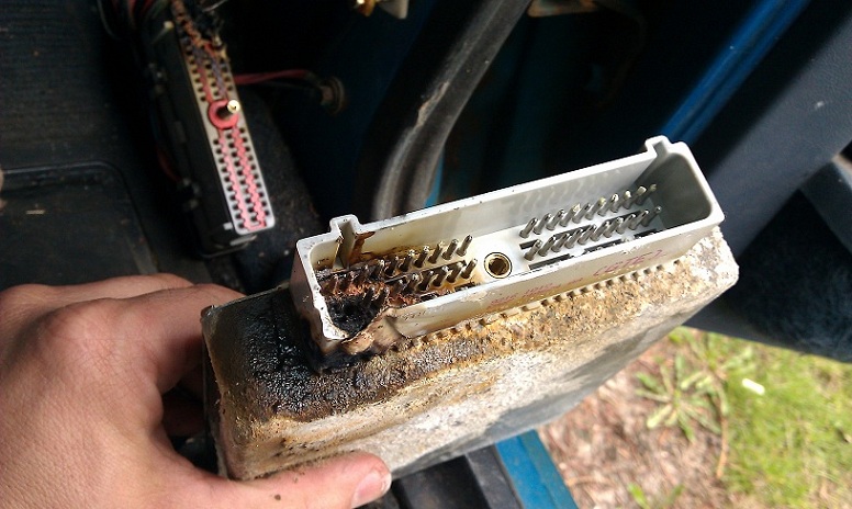

Ummmm.... I think I found my problem:

Anybody have an EEC module for a 92 (or compatible) V-6 4.0L MANUAL trans?
I'm going to have to chop the wiring harness off as the current connector is toast- literally.

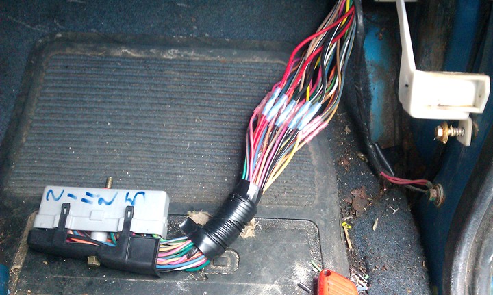

Sat there doing the brain surgery and spliced in the 38 wires into my old wiring bundle- not a very comfortable position to do that....
All set for the new box. I think she just might live again, and just might make that half-million mile mark... ;)
Wow! Dude that's awful.
Is your windsheild or cowl leaking into the cab?
There's a rusted out area at the lower corner of the windshield. Plus, when I had the windshield replaced several years ago I'm not confident they sealed it back up all that well.
See that white stuff on my ECU lid? Like yours but much worse. That moisture will work its way down into the main connector harness and you're gonna have a big problem like I did, so I suggest you fix the leak while you can.
