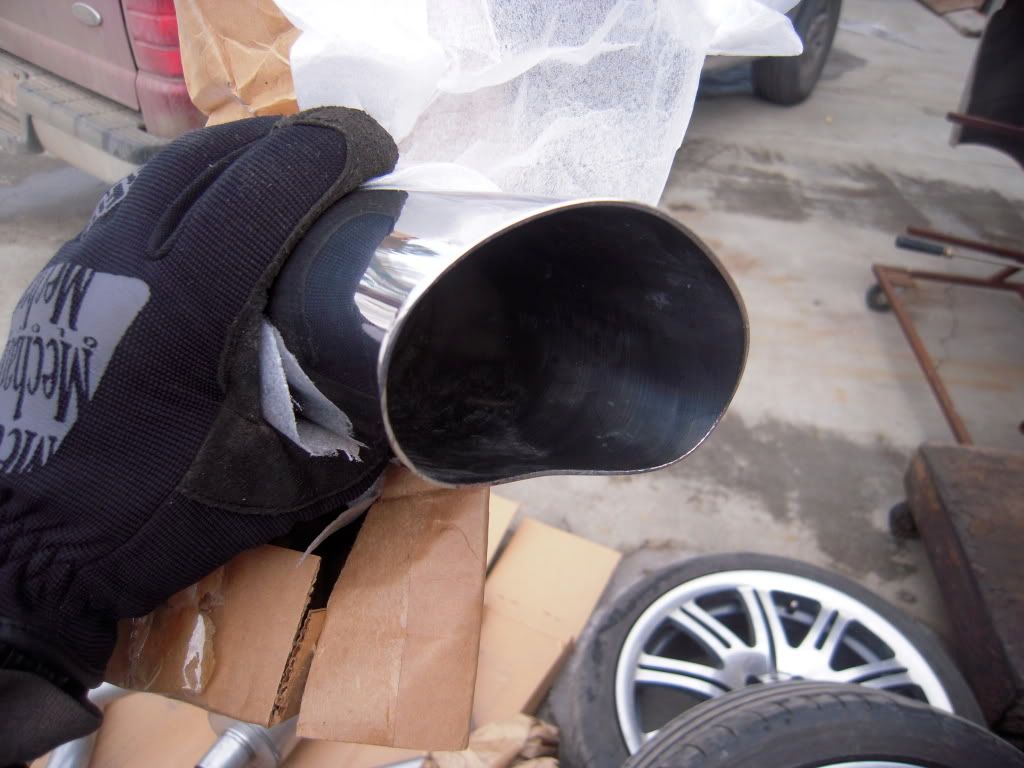

So I finally got started on installing my new Gibson Dual exhaust today. I knew when i ordered it that was for a extended cab, but figured/hoped that i could do some trimming to make it fit. BUT it didn't really work that way.. The head pipe from the collector to the muffler is flanged on one end and did not have enough of a straight section on the other end to cut down enough to get the muffler back far enough from the rear axle. Therefore the tailpipes do not fit properly.. BOOO!!! So i left it as is for now, and it sound pretty mean at idle and low rpm's but kind of gross at higher rpm's under load, plus all my exhaust is getting dumped right on my rear diff. So on monadys morning it's on the way to the exhaust shop down the street from work to get the rear section fitted, muffler properly placed and then the single pipe from the collector to the muffler re-bent and cut to fit! Little more messing around then i wanted to do but whatever! And on top of this one of my tips was damaged in shipping so im in the process of trying to get a replacement from either gibson or the retailer. Hopefully it will be finished Monday, besides the tip which im going to make as round as possible until i can get a replacement.
