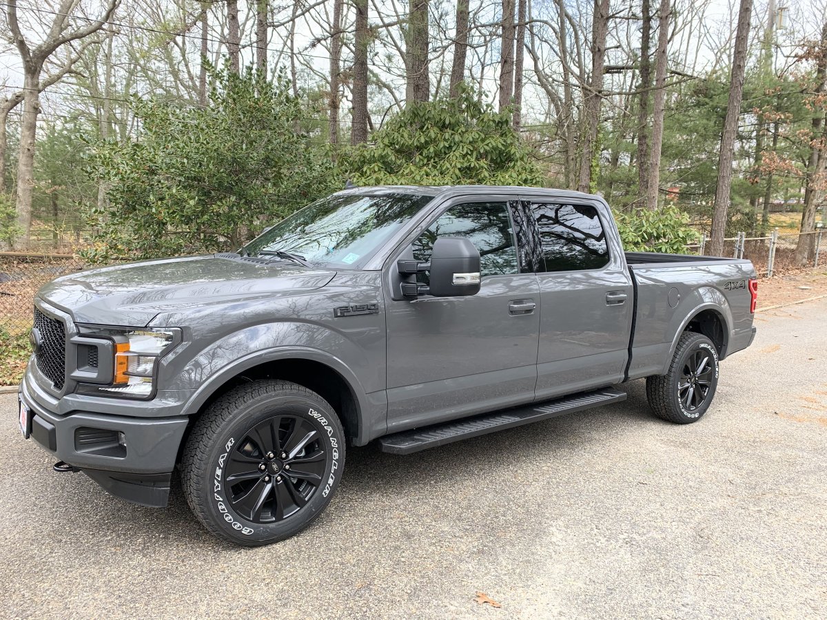

Need increased towing capacity = BUY A LARGER MORE CAPABLE TRUCK...
I increased my towing capacity to 10,500lbs and the GCWR 16,200lbs. It only cost $60k...
