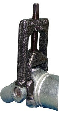

Ball joint/ u-joint presses suck for u joints. They bend the shit out the ears on the yoke. The problem is that you’re pressing on the u joint from 1 side and holding the other side of the yoke. That crushes the yoke. (The other problem is that all of our driveshafts look like we store them in a mix of salt and calcium chloride… which we kinda do.) Most of the time we have to cut the cross out of the old joint, knock the caps in, then clean the rotted pieces of snap ring out of the grooves.
The Tiger Tool U joint puller is pretty good. If it bends the ears (which still happens sometimes), it bends them outward instead of crushing them in. It’s easier to fix it later.
