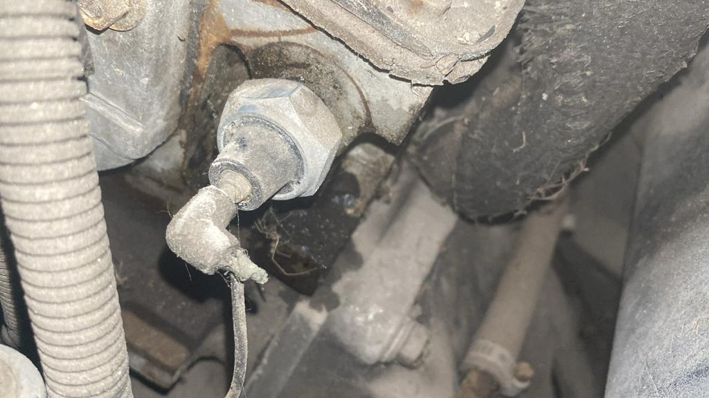

So... is this the coolant temperature sensor? 😅
I'm not 100% sure since Autozone shows me these two options:

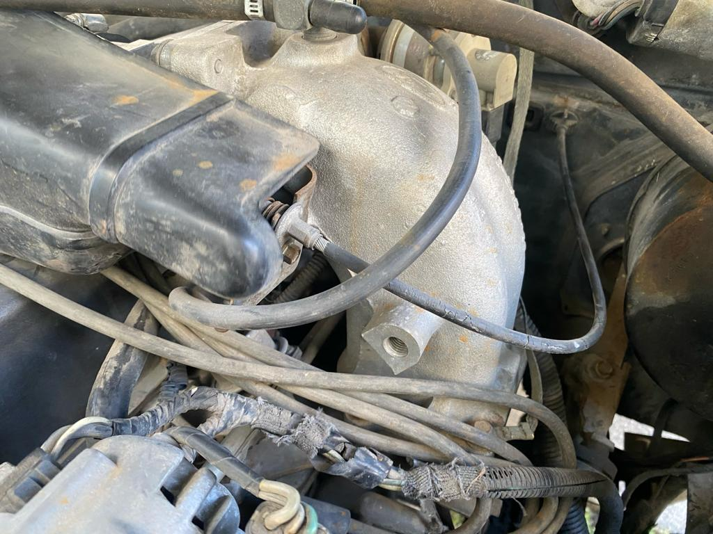

Also, I could not find the air charge temp sensor nowhere 🫠. I found a video on YT of somebody saying it should be here on the intake manifold:
But another guy said there is where the knock sensor should be at.
Any help would be appreciated.
knock sensors weren't used on all versions but yeah I think that's where one would be, I'd ignore it...
The first pic is the gauge sensor, I think the sensor for the computer is in the lower intake manifold by the fuel rail by the #2 injector
Thanks a lot! I'll look for those sensors and senders and change them if needed
