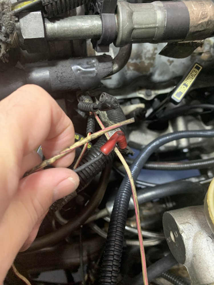

Now, here is one issue. I found a broken wire that I have no idea where it goes. It is attached to the same harness that the oil pressure sending unit and the coolant temp sending unit. I have no idea where it goes. The coloring on the wire seems faded so its either a white with pink stripe or a white with red stripe. It has to go somewhere in that vicinity around the ac compressor, power steering pump, etc. I have been under the truck all over the top of the truck and I cannot locate where it goes.

Oil pressure and the water temp sending unit for the guages are white with red stripe wire and a red with white stripe wire. I can't remember which one goes where. You have two temp sending units. The one with the two wires goes to the computer, the one with the single wire goes to the gauge.

Regarding the wires, I have those two wires as you described, they are connected. Now I am wondering if the white/red was broken somewhere under the harness and that is why I have three wires. I will check that out. I was looking for another sensor or connection location.

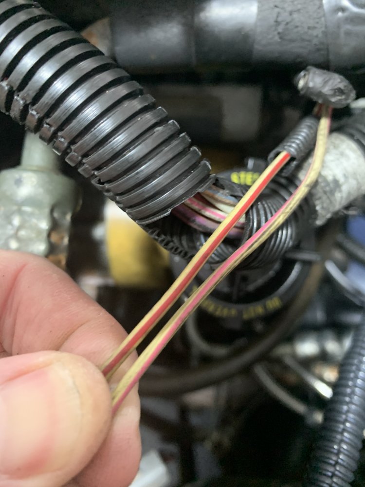

Also, here are two pictures of the mysterious, rogue wire.

Ok, so here is where I am at the moment, I have this white wire with a pink stripe on it. Doing some research, I read where this white pink wire is related to the ignition switch, and somewhere it connects/splices to the red/blue stripe wire that connects to the TFI harness that plugs into the TFI. The fact that this wire is not connected makes me wonder if it is indeed my no spark culprit since it allegedly ties into red/blue stripe wire on the TFI harness?
This wire was broken somewhere when we were moving the harness out of the way. It is one of three wires on the little pigtail harness that goes from the grey connection that is mounted to the driver's side inside fender (below the coolant reservoir and next to a black connector also connected to the fender) to both the coolant temp sending unit (W/R stripe wire), oil pressure sending unit (black/blue stripe wire) and this unknown white/ pink stripe wire. The harness splits and the other, larger part of the harness routes down to the NSF and another connector on the transmission.
I have removed all of the wire loom coverings from most of the harness where I think this wire would connect given its length, and I haven't found anything yet.
One diagram shows that the splice, assuming it's a splice, happens at a location called S121. It ties into the r/ blue wire AFTER the neutral safety switch, which leads to the TFI module.
Another thing I read says that the white/pink wire is a ground wire, but I am not so sure about that one.
Does anyone know or can check to see where this wire leads, or possibly tell me where the location of S121 may be located in a diagram?
