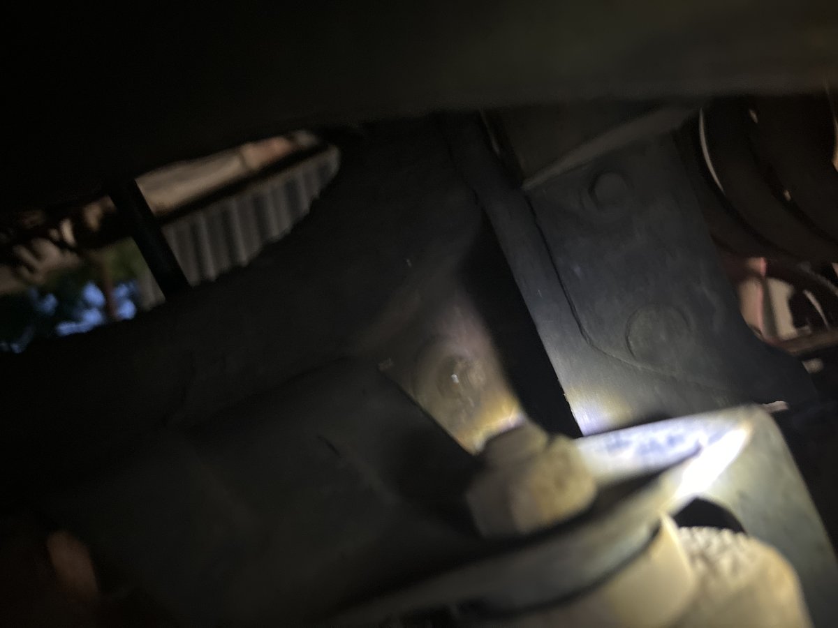

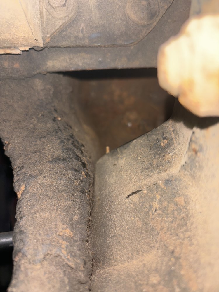

Does anyone have any tips for getting the passenger side engine mount on an 89 off it’s in a really weird spot and no matter what I try I never have space to try and break it free. I got the best pictures I could I need help asap

Are you changing the mounts or pulling the engine?
Have you tried a crow's foot? Might allow you to get a different angle of attack.
I'd use a flex socket on an extension.
sorry i haven't answered anyone, i got the bolt using a long extension and a u joint. and i have already pulled the engine and was replacing the mounts before putting it back in
